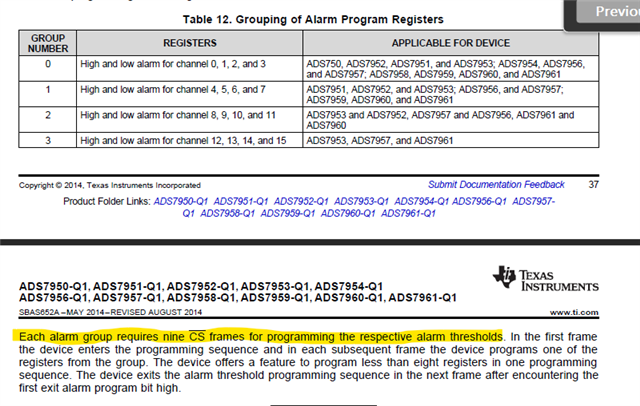

I am attempting to program the ADC_ads7953-Q1 GPIO 0 and GPIO 1 output alarms. I am failing to get the alarms to trigger when i attempt to force them to go high. I attempted to force them high by changing their Low alarm to activated below 0xFFFF and the High alarm to be activated above 0
I am referencing the datasheet
"ADS79xx-Q1 8-, 10-, and 12-Bit, 1-MSPS, 4-, 8-, 12-, and 16-Channel, Single-Ended,Micropower, Serial Interface, Analog-to-Digital Converters" (ADC_TXIIS238478-1) - Section 7.6.
Per the diagrams and tables
I believe the sequence should be:
1. 0x4063 //GPIO Program-Register Settings; GPIO 0 and 1 pins should be outputs
2. 9 CS bar frames
3. 0xF000 // Frame 1 - per table 12 alarm program reigsters group Number is 3
4. 0xE000 //1110 High Alarm for Channel 15 xx00 0000 0000 Frame 2 - I would expect this line to program the GPIO 0 High alarm register to be active when the input in Channel 15 is greater than 0.
5. 0xCFFF //1000 Low Alarm xx11 1111 1111 Frame 2 - I would expect this line to program the GPIO 1 Low alarm register to be active when the input in Channel 15 is less than the Max.

    With that said, I believe the problematic command would be the first one. Bits 3-0 should only be set to 1 in the case that the GPIOs are not configured for special functions. Since you have set GPIO1 and GPIO0 as the low and high alert pins respectively, setting those bits could cause the conflict.
    Can you explain what is meant by the 9 CS bar frames? Just SPI frames with no input data (all 0's)?
    For the 0xCFFF frame, bit 13 needs to be set to exit alarm programming mode in the next frame. Therefore is should be 0xDFFF.
    Afterwards, you would need to collect conversions to compare against the thresholds set. You can use manual mode for this.
    Joel
  • I think the 0x4060 resolved it for me.
    the nine CS bar frames was referring to you document. I did use the manual mode for this.
