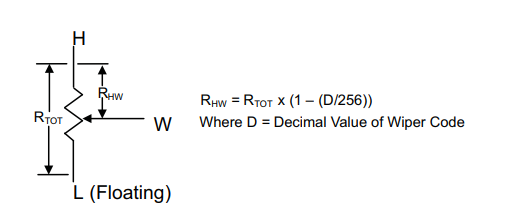

4). In our case we will be using only HA and WA. HA will be connected to TRIM and WA will be connected to the +VOUT of the DC DC Converter. LA, HB, WB and LB will be left floating

    4) This is fine. You'll be operating in this mode:
