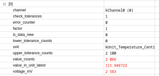

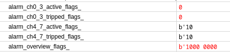

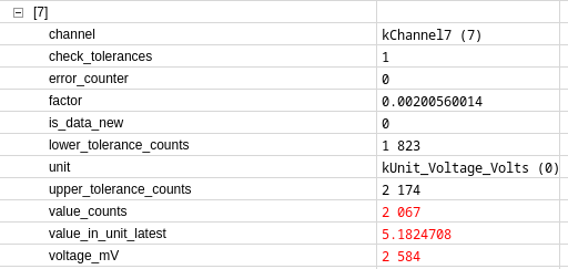

    The value I read from the ADC is 2067(0x813) and the value I configured in the adc low threshold is 1823(0x071F). And the behavior I notice is that it always triggers the low threshold as long as the low threshold is higher than 0x01F, (0x01F comes from me experimenting putting down the threshold until it stops triggering).
    Note: The error counter shows an internal calculation of how many times I think that it should have triggered, this is not related to the alarm registers reading. The alarm registers are in the next image.
    value_counts is what I read from the ADC. lower_tolerance_counts is the lower threshold configured for the alarm. upper_tolerance_counts is the higher threshold I configure for the alarm.
    I notice the alarm being triggered both in the alarm pin and in the alarm registers.

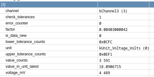

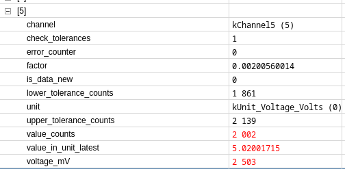

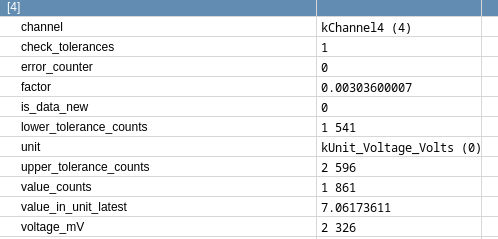

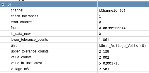

    For reference I show you the other channels which are not triggering and are working correctly:

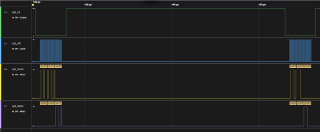

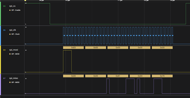

    I send you in the following image the spi communication for configuring the channel 7 alarms:

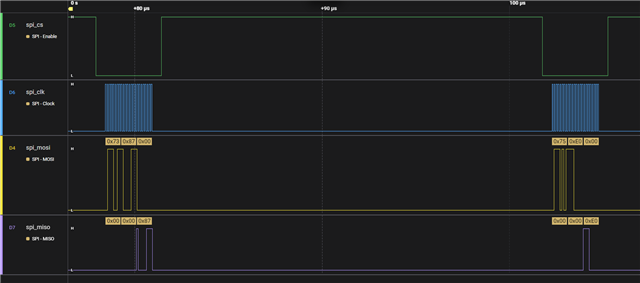

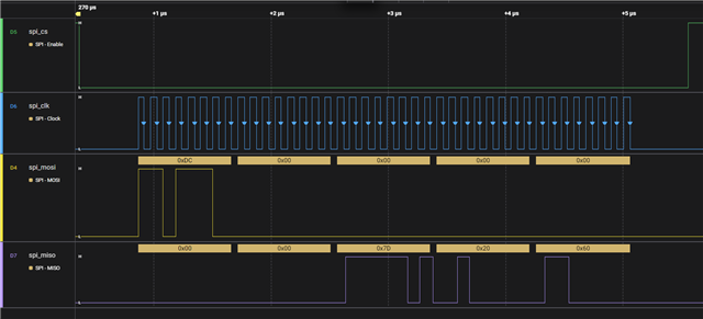

    In the following image is the reading of the ADC channel 6 counts, with the command for next receiving channel 7:

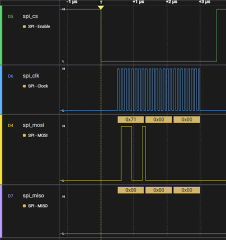

    And the following is the reading of the channel 7:

    It helped understand that even though 0x71F is being configured as the lower threshold, it appears to be responding to 0x1F.
