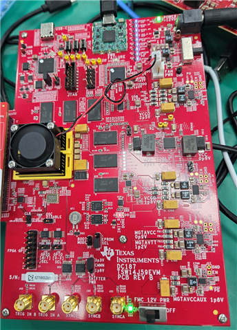

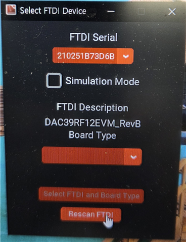

There is connection issue in GUI.
Customer can't not find DAC39RF10 in the connection list in GUI.
Hey David,

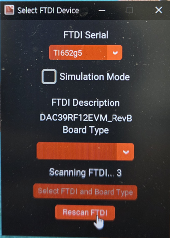

The FTDI connection appears to have occasional problems finding all four ports of the FTDI device on the DAC EVM. The software will only connect to an FTDI device with four ports (FTDI also has 2 port and 1 port devices).
After pressing rescan FTDI one can try to re-select the serial number of the EVM (Above it is selecting the FTDI port used for the FPGA after re-scan is selected).
Try this a few times and eventually it should select the proper TI652g5 serial number and have a board type to select.
This problem is intermittent so it may take me some time to debug and release a new version. The intermittent nature should allow you to get a connection however using the procedure.
