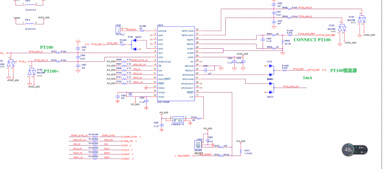

We are using the ADS114S08B to design a 4-wire PT100 circuit. The design utilizes AIN8 as a constant current source (IDAC1), intended to provide a 1mA excitation current to the PT100 sensor. However, upon startup, the system consistently fails to output correct temperature data. The root cause has been isolated: the 1mA constant current source on AIN8 is not activating.

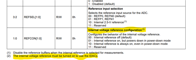

    Please make sure to turn on the ADC internal reference for the IDACs to work. The IDACs are powered by this reference. Note that you do not have to select the internal reference as the reference source (REFSEL bits), but you must enable the internal VREF for the IDACs to work
    This is stated in the datasheet:
