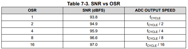

    For case 2, where averaging is enabled and there is an OSR = 2, the ADC output speed needs to be reconsidered
    The sampling speed is halved because the ADC needs OSR times of sample clocks to collect all the measurements and output an averaged out value.
    This would in turn end up being ~OSR * Latency --> making is ~112ns * 2 --> ~224ns

    Thank you for the clarification. I now understand that the latency scales directly with the Oversampling Ratio (OSR).
    This relationship wasn't immediately obvious from the datasheet. My initial interpretation was that the latency was a fixed delay measured after the final sample in the decimation window was acquired, regardless of the OSR setting.
