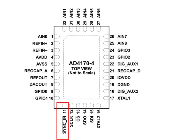

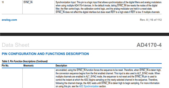

  • Hi Kang,
    The sync pin or signal is that the FPGA synchronizes all the DACs and ADC in the board. It is the output coming from the FPGA and connected to DACs IC so that FPGA has a control to sync all the ADCs and DAC.
    I have attached the images for your reference
    Abhishek

  • Hi Kang,
    My requirement is that all the ADC and DAC IC get an input signal from FPGA to have synchronization between all the DAC and ADCs in the board.
    In board I'm planning 3 ADCs and 10 DACs for my application.
    The SYNC IN signal is coming from the FPGA is fed to the ADCs and DACs as input signal.
    The signal from the FPGA may be a single SYNC IN signal for all the ADCs and DACs or  we use different sync signals like SYNC IN1, SYNC IN2,..... will be send to each of the ADCs and DACs IC. The function of the synchronization is this, the pin name can be SYNC in or LDAC etc. I want the signal coming from FPGA need to be communicated with ADCs and DACs in the board.
    This is the must requirement for DAC.
    Abhishek
  • Hi Abhishek,
    The DAC3283 does not support the feature that you listed above.
    -Kang
