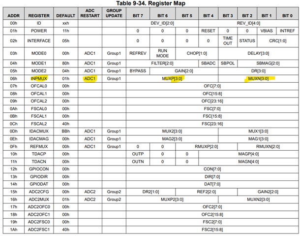

I am using the ADS1263 with a Teensy 4.1 microcontroller in differential mode.
My application requires me to switch between three different channels (AIN0, AIN1, AIN2) to acquire a single sample from each channel sequentially. My current configuration is:
  • Data Rate: 7200 SPS
  • Filter: SINC4
According to Table 9-13 of the datasheet, the first conversion latency for this configuration is 0.980 ms. To account for this, I have implemented a short delay after each channel switch. However, I am encountering an issue where only the first channel (AIN0) provides a correct reading. The subsequent channels (AIN1 and AIN2) appear to contain residual data or "garbage values" from the previous channel, suggesting that the digital filter is not fully settling before the next conversion is read.
I have already tried using a delayMicroseconds() call to ensure the required settling time, but the issue persists.
Could you please advise on the recommended method for high-speed, sequential channel switching to ensure data integrity for all channels? Is there a more robust approach than using a simple delay?
Thank you for your assistance.
Sincerely,
Sania

  • Hi Sania Rahman,
    You do not need to account for the first conversion latency when switching the mutiplexer, you can see from the register map that the ADC will automatically restart the conversion process when you write to the INPMUX register (assuming the device is in continuous conversion mode). I have highlighted this in the image below
    So you just need to wait until DRDY drops low each time to start reading back data. Your sequence would look something like this:
    • Perform initialization
    • Start conversions
    • Wait for DRDY to drop low
    • Clock out data
    • Change INPMUX settings
    • Clock out data
    • etc.
    If this does not work then you will need to provide logic analyzer captures showing the communication between the ADC and controller. Please include SCLK, DIN, DOUT, CS, and DRDY.
    -Bryan
  • Hi Bryan,
    Thank you for acknowledging my problem and for your helpful guidance. I went through your instructions and followed the suggested approach. However, I was still unable to resolve the issue on my device. Interestingly, when my colleague tried the same solution, it worked on his setup.
    We then programmed the same code onto my device, but it continued to fail. This led us to investigate the hardware side. During debugging, we discovered that the IC had been misaligned with its respective pads. Since the device was pre-soldered by the manufacturer, we had not initially noticed this assembly issue. The misalignment was causing improper connections and, as a result, incorrect readings.
    After reworking the hardware and ensuring proper IC alignment with the PCB pads, the readings became accurate.
    Thank you once again for your valuable support and guidance, sir.
    Sincerely,
    Sania
