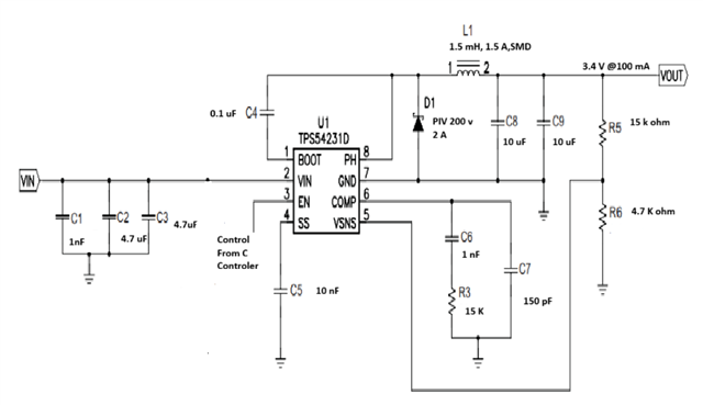

TPS54231: Review circuit and observed 1.8 V ripple @90 mA
Part Number: TPS54231
Hi ,I am design a buck converter for 4.4 V (100mA).At no load condition i am observing 50 mV ripple.But in 80 mA load , I am observing 1.8 V ripple and efective DC voltage is 3.8 V in that Case.I am aatching my design calculation with circuit circuit .So suggest possible improvement with rationale to make my design correct under load condition.I have the limiataion to use this IC only for my Application.So suggest possible resolution with above IC consideration only/
BUCK_DESIGN_NEW.pdf
Thanks and Regards
