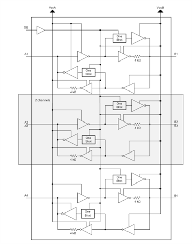

Use TXB0104QRUTRQ1
If a set of input signals is not used (EX A4 and B4),
Can A4 and B4 unconnected (NC)? or recommend to VCC? gnd?

It is always good practice to not leave floating inputs as this may potentially couple unwanted noise into the device. A weak pulldown resistor (~100kohms) should suffice.
