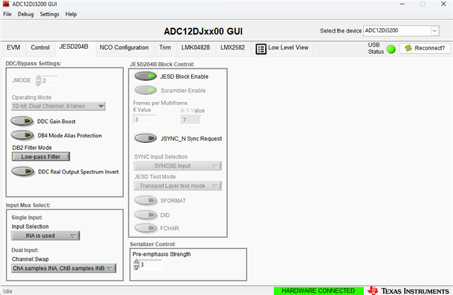

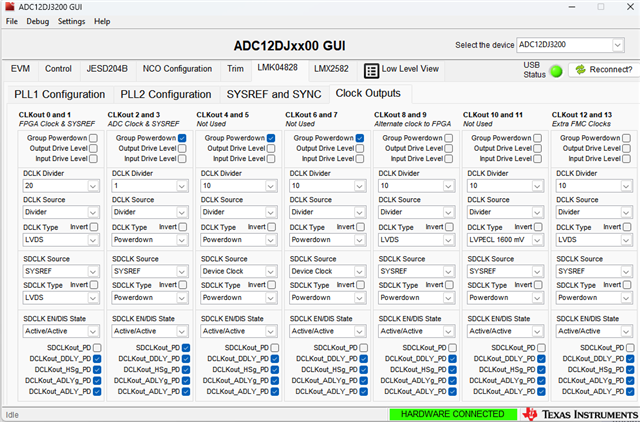

  • Hi
    Now we are able to reduce the Sysref by following configuration as highlighted in the below screenshot.
    As mentioned already, our F=8, K=8, with this configuration also we see the same behavior. We tried different LMFC offset to shift the LMFC edge and SYNC but no change in behavior.
    Can you please review our configuration in the ADC EVM GUI and let us know if there is something missing?
    Many thanks for your help.
