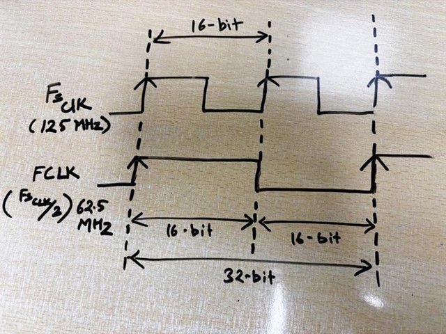

I’m currently working on a prototype project where I plan to interface the ADC3564 with the ZCU106 FMC. I’ve reviewed the datasheet thoroughly and prepared a configuration script based on the register settings provided.
In this setup, the ADC will be used as a Video ADC, where a pulse-based input from a function generator will be used instead of a direct RF signal from a signal generator.
I intend to configure the chip with a basic setup, and the key requirements are as follows:
  • Interface: 1-Wire (1 lane per channel)
  • Resolution: 16-bit
  • Sampling Rate (Fs): 125 MSPS
  • Decimation (DCM): x2 (Real Decimation)
  • FCLK: 62.5 MHz
  • DCLK/DCLKIN: 500 MHz
  • NCO: Bypassed / Unused (No mixing)
  • SYNC: Used for power-down (not synchronization, as only one ADC interface is used per hardware)

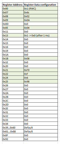

I’ve attached the configuration script along with a highlighted and annotated version of the datasheet. I have a few queries and would appreciate your guidance:
  1. Since I’ve selected 16-bit resolution, should the zero-padding be applied to the LSB bits (D0, D1) or the MSB bits (D14, D15)?

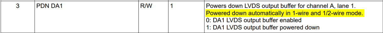

  2. Do I need to explicitly program registers 0x39 to 0x60 and 0x61 to 0x88 for the output bit mapper for Channel A and B, respectively?
    • If yes, could you please verify whether the attached configuration is correct?
    • I came across a note suggesting that the output bit mapping might be handled automatically based on the selected configuration. Could you confirm if manual programming is still required?
  3. Is it feasible to operate the ADC with only one channel and one lane?
Lastly, could someone kindly review the attached script to verify the register configuration sequence and values? I’ve also included the updated datasheet with my highlights and comments for reference.
Thanks in advance for your support!

    I’ve attached a snapshot of the register configuration Excel sheet for your reference. Please take a look and let me know if any modifications are needed based on the above queries.

    A few comments regarding your config:
    1. All registers are set to 0x0 by default, so it is not necessary to write 0x0 to these registers.
    2. The "Must write 1" in register 0x08 is a typo, you do not need to write 1 to this field as it is 1 by default.
    3. The LVDS output buffers in register 0x09 are automatically powered down in 1-Wire mode, so you do not need to power them down manually.
    4. For register 0x0E, if you are using external reference this is correct.
    5. Setting register 0x13 back to 0x0 after 1ms is not necessary. It is listed in the datashett, but we have tested and determined it is not required.
    6. Enabling the bitmapper is not required, so register 0x1B is fine.
    7. You do not need to enable the DDC mux in register 0x25

    1. Lane Power-Down Configuration:
    I observed that Lane 1 of both channels is automatically powered down in 1-wire mode. Therefore, I am not modifying PDN DB1 (bit[1]) and PDN DA1 (bit[3]).
    Since I intend to use only Lane 0 of Channel A, I believe I need to drive bit[2] of register 0x09 to 0x0 (as it defaults to 0x1 after reset).
    Can you please confirm if programming register 0x09 to 0x00 is the correct approach?

    I understand your point on the real decimation mode(which shall be always > = 2) is that what you meant when you said "The FCLK in real decimation, 1 wire mode should be Fs/2", however for example if i would have gone for decimation 4, then FCLK would have been Fs/4, which means it should have accommodated 4x(16 bit) samples, making 64 bit per FCLK cycle (which in my case is 32 bit).
    Is my understanding correct on this?I have attached a hand made diagram snapshot to you,please correct me if I am mistaken.

    1. The reset value in the register map for bits 3 and 3 of register 0x9 are incorrect. Bits 0 and 1 default to 1, and bits 2 and 3 default to 0. This is why I have not programmed register 0x09 in my register config. The register config that I provided to you in my initial post has been tested and verified in the lab, and is correct.
    2. Yes, this is how the ADC is being configured in the config I provided in my initial post. Since this is a single channel device, digital outputs DB0 and DB1 are powered down by default, as mentioned in my answer to question 1.
    3. Yes, I meant to say in real decimation by 2, 1-wire mode. Your understanding is correct.

    1. No, you do not need to set bit 3 to 1. Lane DA1 is powered down automatically in 1-wire mode:
    2. Yes, sounds good.
