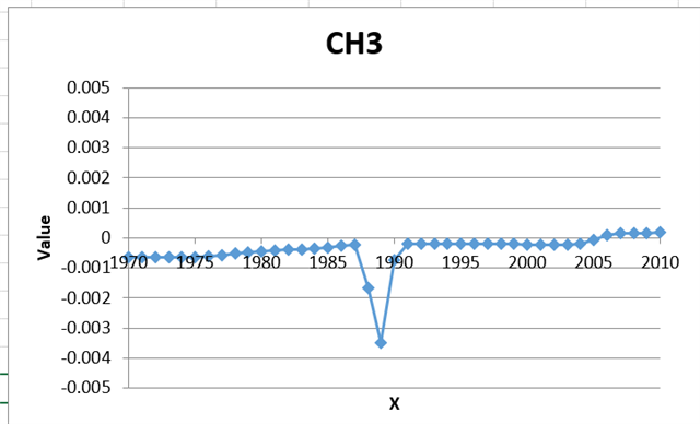

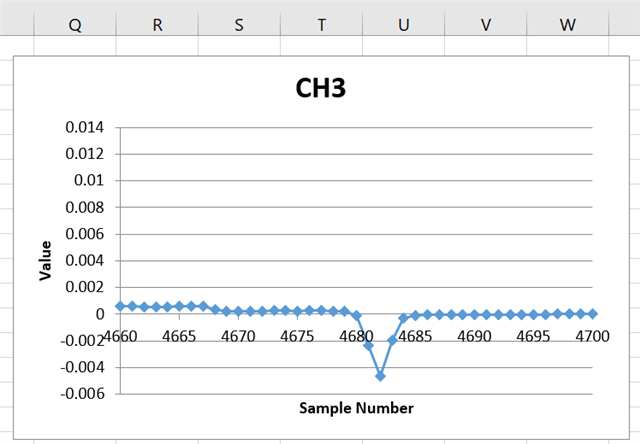

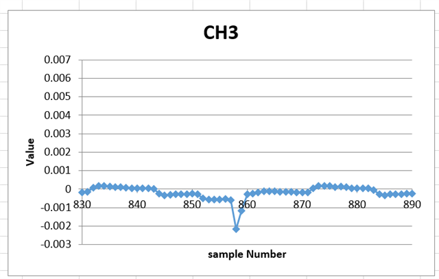

    - I have attached the extract of the noise spike images at 2kSPS, 4kSPS and 8kSPS from the excel sheet.
    - We increased the burst duration from 1mS to 100mS and 1 Sec. The spike always appears at the start and end of the burst signal irrespective of the burst width. This behaviour I could not understand completely. I could only come-up with the explanation as mentioned in the query (first message). If it is aliasing noise, we would expect noise across the low frequency pass band isn't it ?

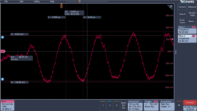

    - I have attached the 50kHz signal seen at the ADC input after RC filter (4.99k and 4.7nF) with respect to SRB1.

    Spike Seen with 8kSPS
    Spike seen with 2kSPS
    Spike seen with 4kSPS
    50kHZ single ended at the CH3 Input with respect to SRB1

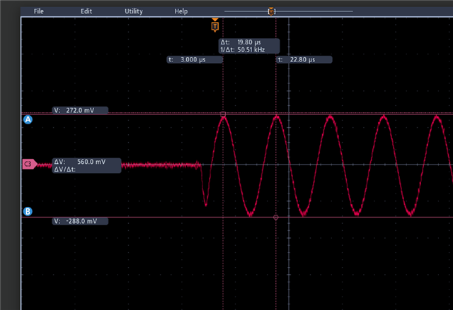

    At the ECG simulator (Before EVM) - Differential 50kHZ Between CH3 and CH5
