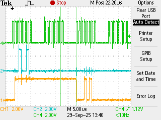

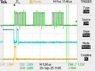

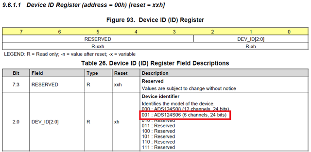

    Here I'm trying to read the Device ID register (00h) expecting to read the value 001
    1st picture shows the CS (yellow) SCLK (green) and SDI (blue) lines
    2nd picture shows the SDO (yellow) SCLK (green) and SDI (blue) lines
    There is probably a stupid problem, but I can't find it.

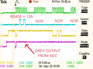

    EDIT:
    I've tried this sequence:
    - Power up
    - START/SYNC = 1
    - Delay 10ms
    - Send RESET command
    - Delay 10ms
    - Send the RDATA (12h) command in loop every 1s, the ADS124S06 response is a fix value FF8A00h

    Can you try reading some other, nonzero default registers instead of the ID register? Do this immediately after powerup and let us know the result. I highlighted a few below
    Please also probe the DRDY pin when you are trying to read conversion data (this is not necessary when you are trying to read back register data). You should confirm that this pin is continuing to toggle at approximately the default data rate when you are trying to read conversion data. If the DRDY pin is not toggling, sending repeated RDATA commands will just give you the same data over and over.

    I am not really sure what is going on here. Is it possible there is contention on the SPI bus due to the other components? It is odd to me that the DOUT pin always seems to be high. You mentioned there were 3x DACs on the bus, correct? Can you try removing these just to make sure they are not causing an issue? Hopefully there are resistors or some other component that can be removed to disconnect the SPI bus from the DACs without having to remove the DACs themselves.
    You also show different grounds for your analog (AVSS) and digital (DGND). Are these connected anywhere on your board? We normally recommend using a single, solid ground plane for both analog and digital, but it is possible to use separate ground planes if you are careful
    If possible, I'd also recommend getting an ADS124S08EVM. This provides you a known working solution that you can 1) use as a controller for your board so you can verify the hardware is working correctly, and 2) use as a peripheral for your firmware to make sure that is working correctly as well.
    One other thing: you said the data was FF8A00h in a previous post, but I don't think that is correct. Your controller should be capturing data on DOUT on the falling edge of SCLK, not the rising edge. From the images you provided it looks like DOUT drops low as soon as SCLK rises high, which should be read as a 0, not a 1. This is not the source of the problem you are having, but it is one issue that needs to be resolved
    Finally, the scope pictures you are sending cannot be made larger for some reason. You will notice that if you hover over the images I sent you, or even your schematic image, then the cursor turns into a magnifying glass and you can make the image larger. This does not happen for the scope images however, so they are very small and difficult to read. Can you try to remedy this if you post new scope shots? You can confirm after you post by hovering over the image as I described. Then, if that didn't work, try editing the post with new images
    -Bryan
