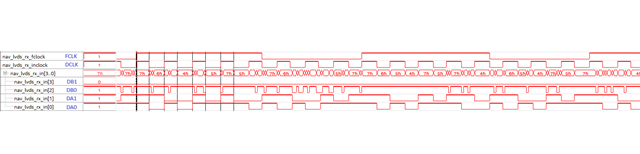

I am working with the ADC3563 and trying to verify all LVDS lanes using the built-in ramp test pattern. My setup is configured for dual-band complex decimation by 32, so I expect to see the same ramp pattern on both the DA and DB lanes. I prepared this question with the help of AI, but it really showcases my problem. The AI just finds better explanations ;-). I hope you don't mind.
Observation:
  • The DA lanes (DA0/DA1) are working correctly. I see a synchronous data pattern that matches the FCLK and DCLK. I have not yet deserialized the data inside the FPGA.
  • The DB lanes (DB0/DB1) are not working. I see a high-frequency, asynchronous signal that looks like noise.

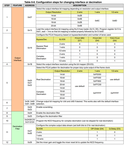

    Thank you for sharing the details about your issue. Yes, your configuration is incorrect. When programming the ADC3563, you MUST follow the register configuration sequence listed in Table 8-8 in the datasheet.
    Below is the correct sequence for your configuration, which I have tested and verified in the lab:
    0x0     0x1	// Reset
    0x7     0x4b	// Configure output interface bitmapping
    0x13    0x1	// Efuse reload
    0x1b    0x88	// Configure output interface resolution
    0x24    0x0E	// Enable DDC, set both DDC inputs to CHA
    0x25    0xD0	// Set dec factor to 32, enable DDC Mux
    0x27    0x10	// set I/Q order for CHA
    0x2e    0x10	// set I/Q order for CHB
    0x19    0x80	// Configure FCLK settings
    0x2a    ????	// Configure NCO A to desired frequency
    0x2b    ????	// ...
    0x2c    ????	// ...
    0x2d    ????	// ...
    0x31    ????	// Configure NCO B to desired frequency
    0x32    ????	// ...
    0x33    ????	// ...
    0x34    ????	// ...
    0x26    0x88	// Enable 6-dB mixer gain for NCO A and B
    0x26    0xaa	// Assert phase reset for NCO A and B
    0x26    0x88	// deassert phase reset for NCO A and B
    0x14	0x04	// Set custom pattern to ramp pattern step size of 1 in 14-bit mode
    0x15	0x0	// ...
    0x16	0x48	// Set Test pattern to ramp mode for CHA and CHB
    I included the configuration for test pattern as well. You can simply set those registers back to 0 when you want to exit test pattern mode.

  • Thanks Luke!
    this did exactly what I intended. Now both channels contain the ramp pattern.
    I don't know where I lost track, since I did also try to implement the register configuration sequence from the datasheet, but it did not work, so I started to fiddle around and ended with the "configuration" I posted here...
    Anyway, your solution works flawless.

    In regards to swapping the I/Q order, that is a good question. I followed the guidance for registers 0x27 and 0x2e in the table, which indicates for 2 wire mode, you should configure bit 4 (OP Order) to 1, and bit 3 (Q Delay) to 0.
    I think something may have been lost in translation when this datasheet was made, as the description for the OP ORDER and Q DELAY fields are not completely accurate. These fields must be set to the below values for their respective modes for the proper output data.
    But, as you pointed out, this does not matter for test pattern mode. It will, however impact the actual output ADC data if these are programmed incorrectly.
