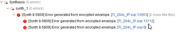

  • I've reached a point where now I'm just getting the following error:
    So something in my modified wrapper is incorrect and because of the encryption there is no way for me to debug it further. Please advise on how I get a working mgt_8b_10b_wrap for the Artix-7 using it's gtp. The manual does say this part is supported but, again, there is no working example to base a design from.
