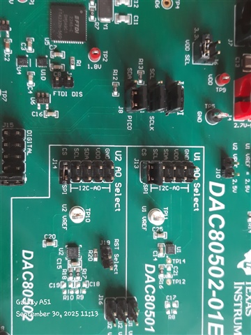

    What jumpers do you have populated on the board? The following image shows the proper configuration for SPI. Use J6 to apply voltage to the device. Also measure the 5V and 3.3V voltage to ensure the voltages are correct. Finally, make sure you're unchecking the "Demo Mode" box, if it's checked no commands will go to the FTDI.

     Unfortunatly your system is not aloowing me to upload more than a single image onto thisa thread so i am going to respond with more pics  so you can see what's going on. The pic below is of the jumpers setting on the board which to me seems to match your usre guid but you can double check. .
    For DAC80502 i have  set the values to FFFF and pressed enter which means that it should have written thos values to the DAC register output, correct? But when i put my scope probe on J16 i see no voltage coming out. Is there something i am not doing?

  • Hi Shervin,
    I appreciate the pictures! It looks like you have your jumpers set up correctly and that you're probing the correct output. Could you please check the following voltages:
    -VDD, ensure it's 3.3V
    -U2_VREF, ensure it's 2.5V.
    If these voltages are not present it could indicate an issue.

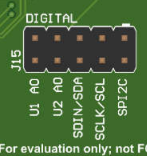

    Great that it works now! You can use J15 to monitor the FTDI SPI outputs. "U2_A0" would be the CS pin for the DAC80502.

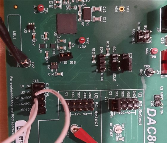

    I tried to drive the DAC80502 with my PIC18f87j90 pICDEM board but i did not see the result i was looking for. I wanted to run the same test where i would command the CONFIG register to turn off the internal ref so i could see the voltage on TP10 drop from 2.5V to zero. I sent a SPI write command which wrote out 0x03,0x10,0x00. This should have turned the ref off by setting the 8 bit of the config to 1. The voltage measurement atTP10 stayed at 2.5V so i am not communicating with DAC80502. Before i go deeper into comparing SPI signals between my processor and the FTDI spi, please look at my board jumper positions and see if they are set correctly for external comms.
    Specifically in the EVM user guide its unclear in instructions if J11 needs to be in or off the board for external comms.? I am assuming it should be removed for external comms?
    Please look at the image below and see if the other jumpers are set correctly for external comms. i have kept J13 in because i am using dAC80502. The black clip wire is the ground from processor board to EVM so they have a common reference for digital comms.
  • Hi Shervin,
    For external communications, you should leave J8, J11, and J14 open, as you've done. The command you're writing looks correct. Make sure you're latching data on the falling edge of SCLK, this is the most common issue I see when it comes to SPI with our devices.
