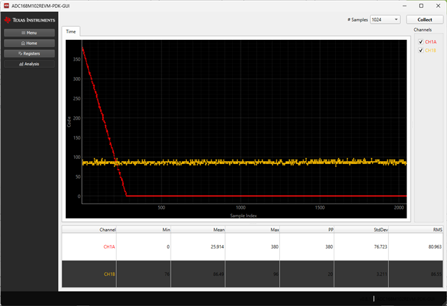

I am working with the evaluation module for the ADC168M102R-SEP. I intend to use it with full clock mode and pseudo-differential mode. I am unable to get analysis sampling of all 8 channels when when using the ADC168M102REVM-PDK-GUI.  The board is set up with CMA/CMB tied to internal VREF. All analog inputs are tied to common. Please advise how to configure and operate to demonstrate readout of 8 input analog channels in full clock mode.
When setting the config register to 0x10C0 (full clock mode and pseudo-differential mode) with Mode 3 (confirmed that M0 = 1, M1 = 0), then when collecting samples it only reports CH1A and CH1B. Below are images for setting the config register, and then collecting 1024 samples

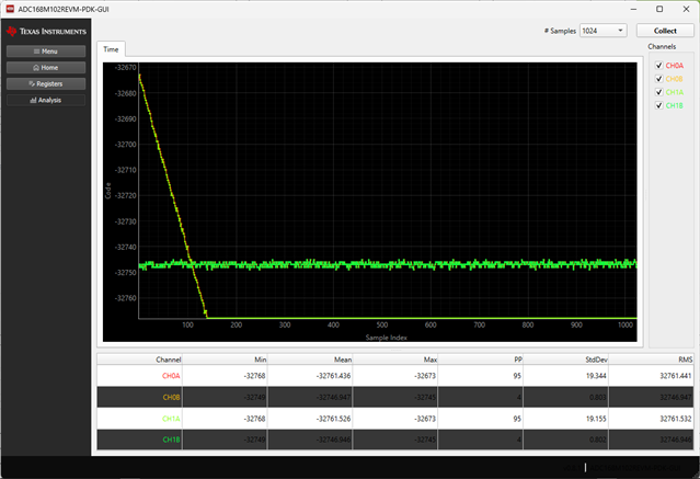

If I sample with config register 0x10C0 and in Mode 1 (confirmed that M0 = 0, M1 = 0) then it reports CH0A, CH0B, CH1A, CH1B:
  • Hi Aaron,
    Pseudo-differential mode currently is broken in the GUI. We are working on fixing it with a software update, but in the meanwhile, can I help to provide direct support? For testing with the EVM, what are you trying to evaluate?

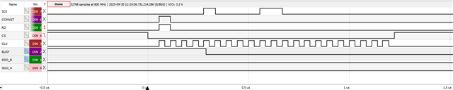

  • I am attempting to demonstrate our use case and most importantly, collect digital IO waveforms to understand what our to-be-designed FPGA should accommodate. We are also looking to understand Mode 3 automatic sequential sampling when using CID=0 and CE=1 with the full clock and pseudo-differential mode. I would appreciate the direct support - feel free to reach out to the email associated with this account and we can coordinate. Thank you for the feedback and offer.
