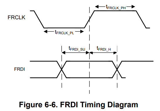

  9. Does FR (Fast Reconfiguration Interface) have some undocumented DDR mode for FRCLK? (Figure 6-6. FRDI Timing Diagram) looks a bit misleading in that regard. Would prefer DDR, if possible.
