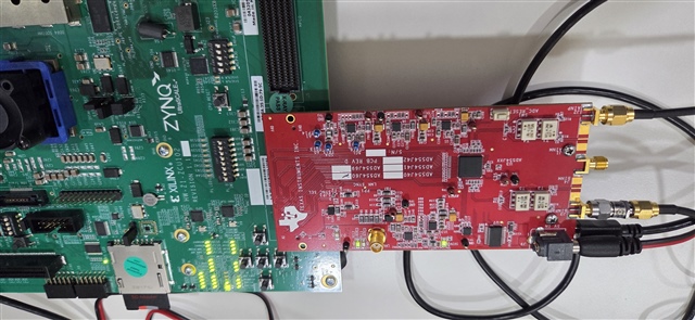

I have difficulty in implementing JESD204 IP receiver in FPGA zcu102 board .

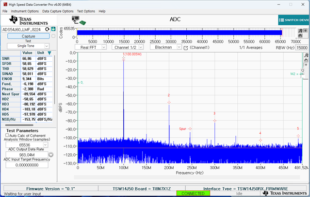

Firstly I have checked the ADC ADS54J60EVM using TSW14J50. (SERDES= 4.9152Gb/s, Device frequeny =983.04 MHz, LMFS=8224, Function generator frequency 100 MHz 10dBm power for CHA and 100 MHz 4 dBm for CHB) It successfully worked as shown in below

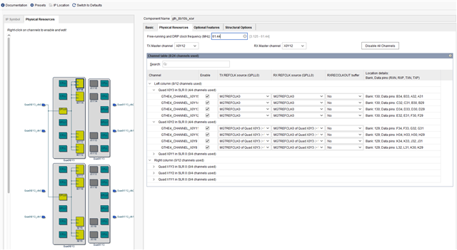

Next I have simulated TI JESD204 IP setting IP_TYPE "RXTX". In the simulation of TI_204c_IP_ref, my gth_8b10b_xcvr is shown in the two figures below
The refclk 245.76 MHz is used to generate an additional 245.76 MHz mgt_gpio_out clk using BUFG_GT. This mgt_gpio_out is used clk_in input for sys_pll which generates two identical frequency 61.44 MHz  sys_clock and mgt_freerun_clock. By passing vio_inst in TI_204c_IP_ref. The simulation successfully works. Finally I made bit file for the receiver setting IP_TYPE "RX". The setting is shown in photo as below.
