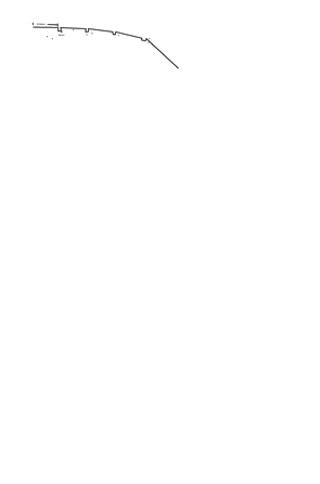

    I try to use ADC for  conversion a signal, change from 1.6v to .9v but it need to be fast enough
    to be able to record 5msec drop  voltage, here is signal
  • Pin to pin replacements? No
    Other replacements that could measure the 5ms voltage drop, probably. What would be the the sample rate or sample count you would need for the attached signal?
    Could anything else be added between your current board and the signal to add a common mode offset?
    Yolanda

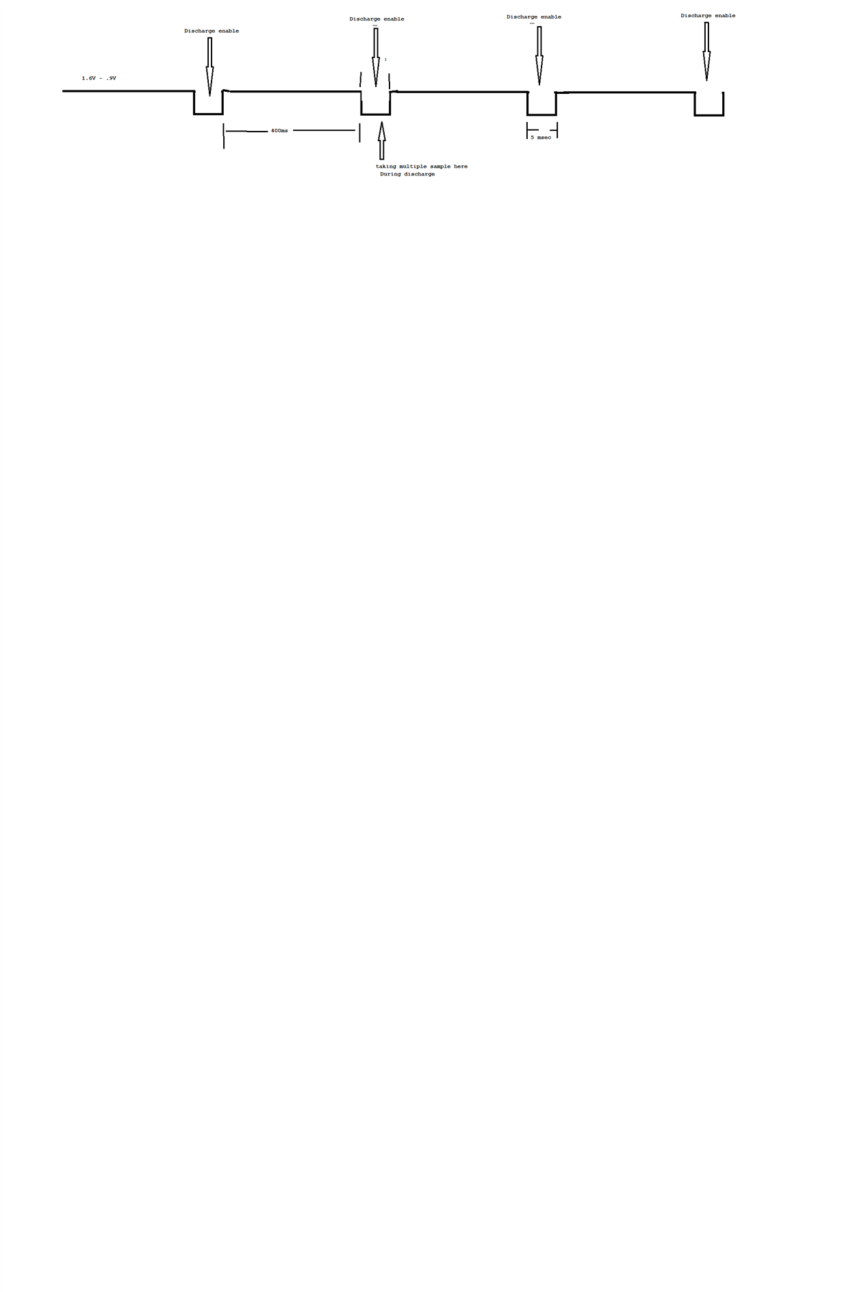

  • I try to use this part in battey dischare design, Battery voltage change from 1.6v to 0 volt under discharge load
    as you can see from the Discharge waveform
    I need 2 ch per ADC, fast enoght to take multiple sample when discharge happen
    (by the ADS8355/ADS7853/ADS7253) are good but my sysetem run on 3.3v not 4.0v
  • If speed isnt an issue then what about the ADS7067, this device has 8 channels, 800ksps, and can work with 3.3V
    It is a muxed ADC and not simultaneous sampling, but if 2 devices are synchronized then you can get two simultaneous measurements between them?
    -Yolanda
