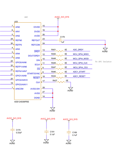

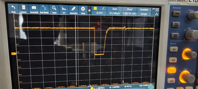

Initially, we used ISO7761DBQR digital isolators between the MCU and the slave devices for galvanic isolation. the salves are connected in the analog isolated section ( Isolator secondary side ). During SPI communication, we observed that the MISO (DOUT/DRDY) line from the ADS124S08 shows a slow rising edge, while all other SPI signals (SCLK, MOSI, CS) appear normal on the oscilloscope. The falling edge of MISO is sharp, but the rising edge is very slow, resulting in invalid data being received by the MCU.
To verify whether the isolators were causing this behavior, we removed the ISO7761 devices and directly shorted the SPI traces between the MCU and the slave devices using jumpers. However, the same slow rising edge behavior remains, even without the isolators in the circuit.

An oscilloscope waveform of the MISO signal is attached for your reference.
The rising edge shows an exponential transition with an approximate rise time of 43 µs.

    If you completely disconnect the DOUT pin from the circuit, do you still see this behavior? Remove resistor R450 in your schematic and then probe directly at pin 12 on the ADC. Hopefully this resistor is physically close to the ADC on your PCB to minimize trace capacitance as much as possible
    This looks like you have some capacitance on the bus that is causing this delay.

    We removed the R450 resistor and probed directly at pin 12 of the ADC, but the same behaviour was still observed. As you mentioned, the R450 resistor is physically placed close to the ADC device.
    Initially, we were operating the device in SPI Mode 1, where this issue occurs. However, when switching to SPI Mode 2, both devices function correctly. As per the datasheet, Mode 1 is the recommended configuration. Could you please suggest how we should proceed further?
    Manikandan V
  • Hi Manikandan Velayudham,
    The ADC requires that SCLK idles low and that data is captured on the falling edge of SCLK (data is launched on the rising edge). The actual mode name is not important, many controllers refer to the modes differently.
    So as long as you are adhering to these requirements the ADC communication should operate correctly
