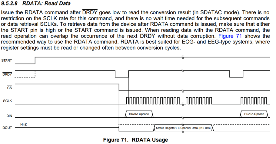

  • Hello Naveen,
    We do not have specific references to provide for reading the data from the ECG simulator. However, "Section 9.5: Programming" of the ADS1298 data sheet provides detailed instructions for interfacing with the ADS1298. Specifically, the "RDATA" command explains how to read ECG data from the device.
    Capture of Section 9.5.2.8 RDATA: Read Data in the ADS1293 data sheet
    Payton
  • Thanks I'll look into it
  • Hi Naveen - just to clarify, RDATA command would have to be sent at the start of every SPI frame, followed by enough 0x00 bytes to read all the channel data. Conversely, you can use the RDATAC mode (default), and data is automatically loaded into the output shift register before each /DRDY falling edge.
