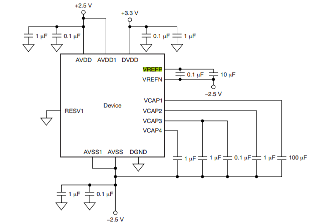

  • I'm considering the following connection.
    In this case, is it correct to understand that this will be the "internal reference voltage"?
    In that case, is it correct to understand that the ADC can be used with a maximum input of 0±2.5V?
  • Hello Takahashi-san,
    Yes, the diagram above shows a circuit using the internal reference voltage.

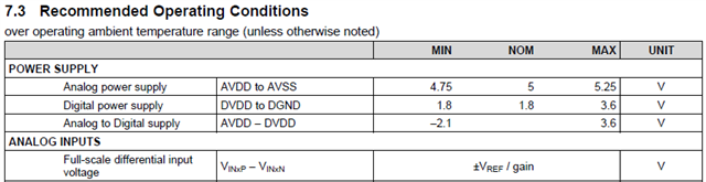

    The ADC's differential input range is defined by the reference voltage, not the analog supplies.

  • Hollo Ryan Andrews-san
    I understand that it operates on an "internal reference voltage."
    I misunderstood that it operated between AVDD and AVSS, but what is the internal reference voltage?
    The gain is planned to be 24dB, but since I need to do some calculations, I'll just assume it's 0dB.
    Will it be 0±2.5V?
    The internal reference is 4.5V in the ADS1299. Therefore, the ADC full-scale range is defined as ±4.5/Gain. Please know that our PGA gain is specified in units of V/V, not in dB. Slight smile
    The absolute voltage on each pin (INxP or INxN) is limited by AVDD and AVSS.
