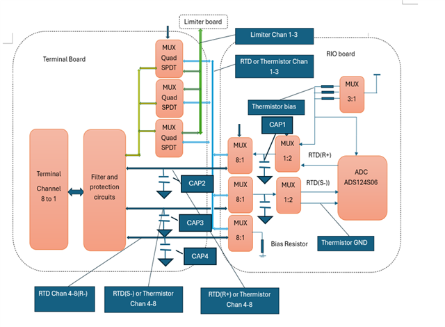

  • Hi Bryan, Thanks for your time and support.
    Sorry for the delayed response — we’ve been focusing on a higher-priority project recently. After further investigation, we identified several conditions that can resolve the issue:
    1. When all RTDs are installed, the issue does not occur.
    2. When only one RTD is installed, removing CAP1(10nF) on the R+ path resolves the issue.
    3. When only one RTD is installed, removing CAP2, CAP3, and CAP4(100nF) on the R+, S-, and R- paths respectively also resolves the issue.
    4. When each RTD is selected individually, the issue does not occur.

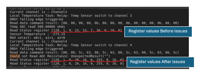

    We observed that this issue causes the register values to revert to their default settings. Please refer to the attached files for more details.
    Based on our findings, it appears unlikely that the SPI is the root cause. However, the exact cause of the issue remains undetermined. Could you please help us further investigate and identify the root cause?

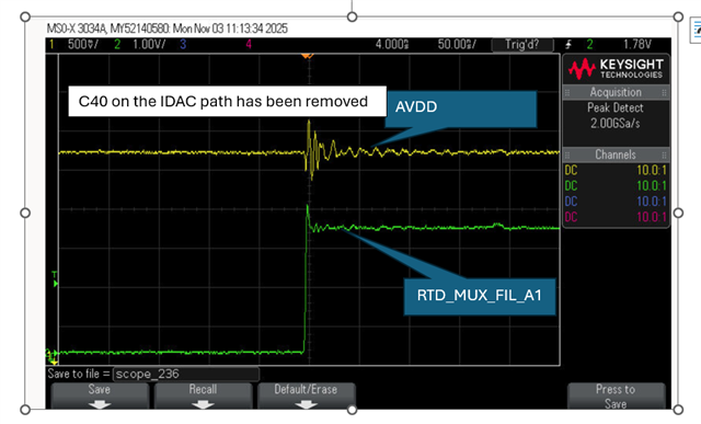

    Also I attached a snapshot of AVDD there is a glitch. Does it cause ADS124S06 to be reset?
  • Hi Han,
    The minimum operating voltage for AVDD is 2.7V. It looks like you're triggering the oscilloscope at 2.66V, so it's dipping below that minimum voltage. A brown-out event will occur, triggering a reset. So that is probably causing your issue with the RTD getting stuck.
    Maggie
  • thanks Maggie, I observed this, yet its duration is under 0.5 µs. Could it still cause a reset? One question remains: why does removing the capacitor from the IDAC path eliminate this issue?
    A fluctuation on AVDD is observed whenever the address lines (RTD_MUX_FIL_A0, A1, and A2) change. Removing capacitor C40 mitigates the fluctuation, and the ADC operates correctly. If C40 remains installed, the fluctuation increases in magnitude, leading to improper ADC operation(?).
    Snapshots of the AVDD waveform have been added to show the difference between the cases with C40 installed and with C40 removed.

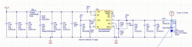

    The LDO (TPS7A9101DSKT) is used to provide the AVDD supply for the ADC, but kindly it does not adequately suppress noise.

    Why do you have a capacitor on the output of your mux? I would think C40 is going to impact the settling of your mux signal.
    Maggie
  • Hi Maggie, I added this capacitor to reduce noise between two boards. The schematic I shared earlier isn’t marked for the different board. Please check the updated one.

    If you remove R4 and then use a bench supply to generate the AVDD voltage do you still see the issue (assuming C50 is still installed)?
    Also, do you not have one of the muxes connected to power? It is drawn this way on your schematic at least

  • Also, do you not have one of the muxes connected to power? It is drawn this way on your schematic at least
    While combining circuits from different schematic pages into a single page for easier review, a typo occurred and the power supply was inadvertently omitted. I apologize for the oversight.

  • Hi IronChef Han,
    yes, The issue does not occur when either the Reset pin is toggled or the ADC is reset by the firmware.
    The issue goes away if you reset the ADC once (presumably with C50 installed and with switching between channels with some RTDs uninstalled)Yes, however, the issue continues to persist even after toggling the power.
    So I understand correctly: if you toggle RESET, the issue goes away completely and forever. But if you toggle the power supply (without then toggling RESET), the issue persists? Is that correct?
    If yes, then it sounds like the ADC is starting up in a weird state, and toggling RESET actually does reset the device to the correct state. I see that you have split grounds (AGND and GND) that are connected by a ferrite. We generally recommend a common ground plane for both analog and digital. It is possible that the ADC grounds are getting pulled apart during startup, which is what is causing this weird state. Then the RESET actually puts the device in the correct state once the grounds "settle".
