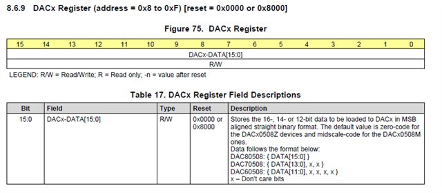

    With these modifications, we are able to get an output of approximately 0.079V on all 8 channels, but we are not able to achieve the required voltage level.

  • Hi Anjana,
    I think is see the issue here: the dac-data is always left justified.  So midscale is not 0x0800, it is 0x8000!
    The 4 right-most bits are "don't-care".  So if you write 0x0FFF, you are actually writing value 0x0FF for the 12-bit register.  0x0FF/0xFFF*1.25V = 0.078V

  • YOu are not writing data correctly to either the Broadcast or the DAC-DATA register.  If you want the DAC output to be midscale, the correct value to write to the DAC input register or the broadcast register is 0x8000.  Fullscale would be 0xFFF0.  You need to left-shift the data 4 bits.
    Paul
