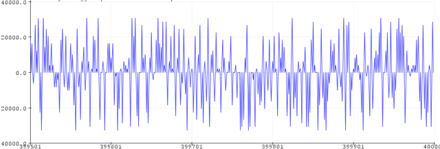

Hello, I am attempting to collect parallel complex decimated data from this device and run into a problem whenever I increase the clock frequency above 500kHz.I have posted some example output plots given the following constant parameters:
NCO Frequency: 500kHz
Input frequency: 503kHz
Decimation setting: 2
Resolution: 16-bit
Note that when I say clock frequency I mean the input clock to the +/- input to the ADC3544, not DCLKIN as I am not using the serial mapper, but instead the parallel DDR data on outputs 1-16. These are plots of only the in-phase component of the complex decimated data.
This first plot I am plotting with clock frequency = 500kHz
For this plot, I am plotting every 10th value with clock frequency = 500kHz
For this plot I changed to clock frequency = 550kHz and plotting every value (input waveform doesn't appear to make a difference)
These plots make me think there is something wrong with the way the data is outputted or collected, but I am not sure what could cause it to work at clock input = 500kHz but not 550kHz. If I lower the clock frequency it still appears to work. Any help would be highly appreciated. Let me know if I can clarify anything.

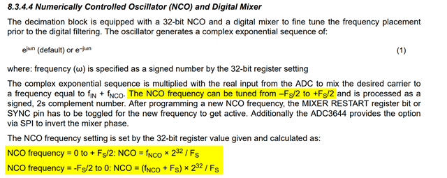

    If my understanding is correct, the configuration you are trying will not work. The NCO frequency is dependent on the sample frequency, and can be set to any frequency between -Fs/2 and Fs/2.
    Luke Allen

    Have you adjusted your NCO frequency to be between -Fs/2 and Fs/2?
    Luke Allen
