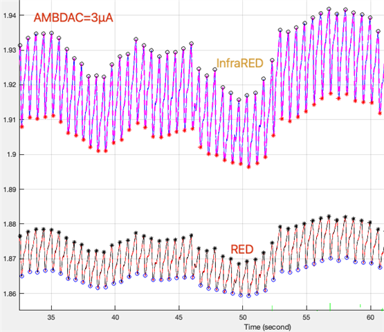

During parameter tuning, I swept the AMBDAC of its allowed values while kept rest register values unchanged.
 When the AMBDAC value equals 3μA, both the IR current  and the RED current exceed 1.2V(after the conversion of TIA), which is the full scale of internal ADC.
This is odd to be understood.
The off-line data are obtained with EVM GUI.
On the other hand, according to formula (2) on page 30 of the datasheet,
shall I expect  negative values of IR and RED waveform, since both TIA and ADC are differential type.
However, I don not see negative waveforms, but ADC overflow when AMBDAC equals 8μA.
Would you please explain these findings according to formula (2)?

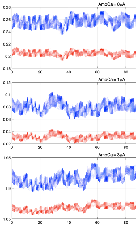

  • Hi Payton
    Thank you for your reply.
     According to formula (2) on page 30 of the datasheet,
    Let us suppose, Ipleth = 0.5μA and Iamb=0 in formula (2).
    A large Icanel set by AMBDAC can make VDIFF a negative value, can't it?
    In fact, the RED and InfraRED optical current waveforms were obtained with various AMBDEC values.  Please find those wavefroms below. The rest register values were kept unchanged during this AMBDAC value sweeping.
    However, I cannot link these waveform values to formula (2) and understand the impact of AMBDAC on waveform.
    Would you please help me?
    Best Regards!
    Wallace
    Above AMBDAC = 8μA, ADC overflow happens.

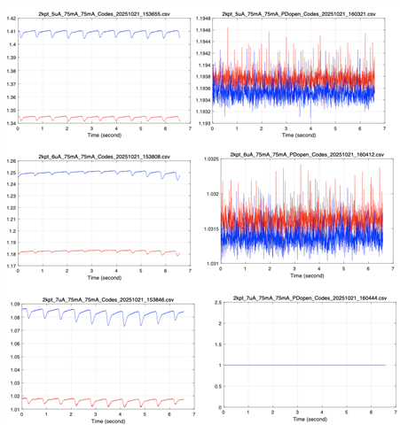

  • Hi Payton,
    Following your suggestion, I did experiment with/without a PD. Here are captured waveforms.
    please review these captured data and help me understand formula (2)
    Best Regards!
    Wallace

  • Hi Payton,
    I review my codes of "two's Complement" conversion and found bugs, indeed!
    Thank you so much for guiding me to this depth!
    Now, after a new round of data post-processing, all data curves make sense to me.
    The Icancel increases 1μA in each row from top to bottom, Vdiff increases -2*Icancel*Rg (in a negative way), according to formula (2). Rg=100kΩ was set in those experiments, so the increment of Vdiff= -2 *1μA *100kΩ= -0.2V
