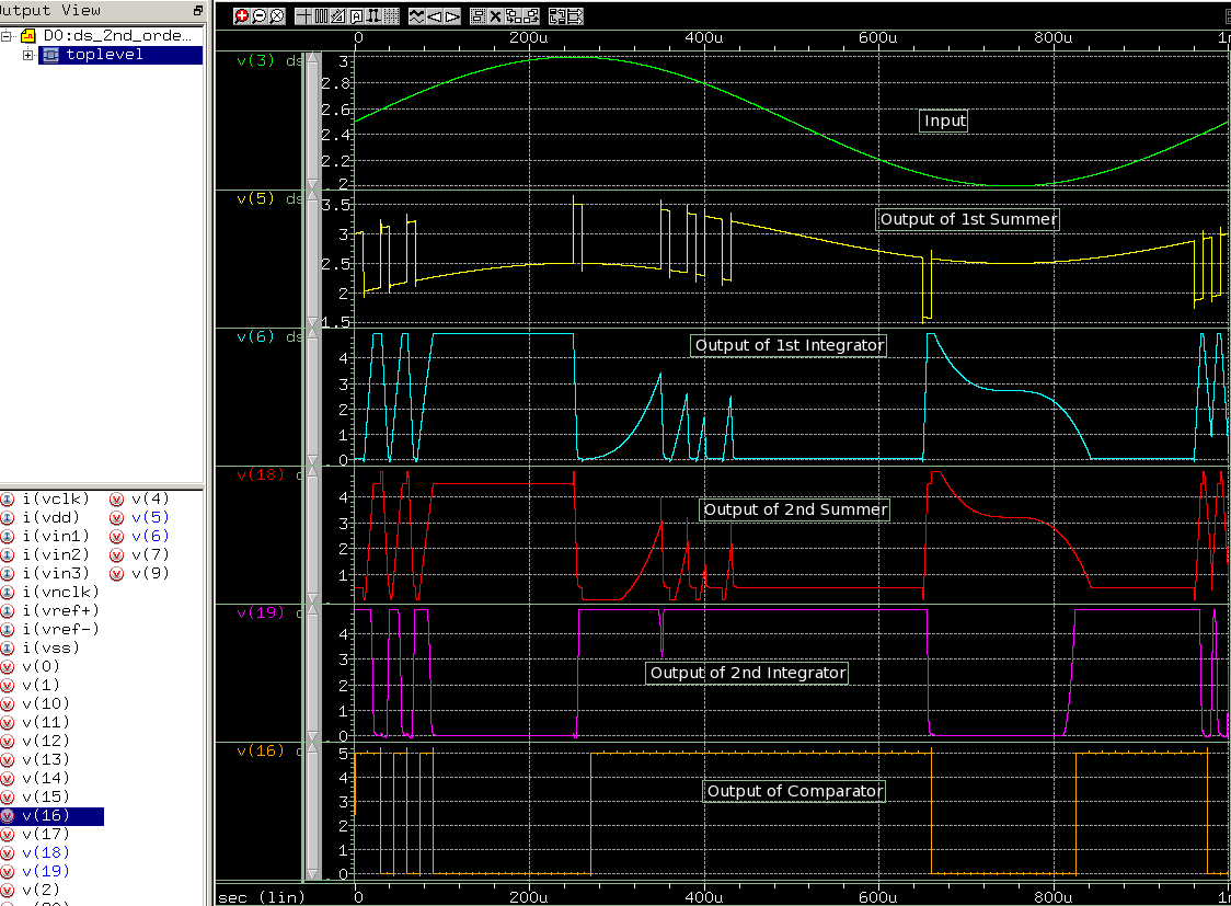

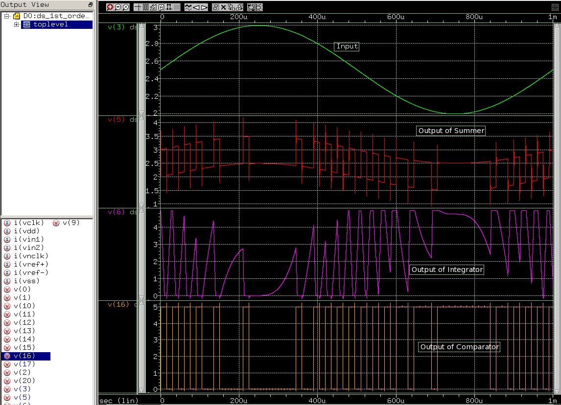

I am Jyothi, an MTech student from India. 3 of my friends and myself are trying to design a Delta Sigma modulator as part of our course work.
We are doing the CMOS implementation of the circuit using HSPICE tool.  We have completed the first order modulator design and we are trying to do the second order design now.
We have obtained a bitstream from the second order modulator, which is different from the bitstream obtained from the first order modulator. As per circuit diagram, we expect it to be different, but just wanted to confirm this.
Are we expecting exactly same bitstream as output from both 1st order & 2nd order or will they be different?
Please help us understand the difference between the first & second order modulator outputs.

  • Hi Tom,
    Thanks for the mail. Actually, we are looking at the bitstream output of the latched comparator of DS modulator. Input was a sine wave of 1KHz frequency and peak-peak amplitude of 1V centred at 2.5V for a supply of 0-5V. We have oversampled at 64KHz.  We have taken DC bias of the MOS circuit as 2.5V.
    We have tried both 1st order and 2nd order and we observe different output bitstream at the latched comparator output. Are we wrong? We have not checked the output spectrum.
    Can you tell us what is the kind of output you are expecting for the above specifications we mentioned. Also, can you kindly tell us how to measure the noise spectrum as shown in Fig. 5 in the app note you have shared (http://www.ti.com/general/docs/lit/getliterature.tsp?literatureNumber=sbaa094&fileType=pdf)  We are using the HSPICE tool for our experiments.

  • Hi Jyothi,
    It's difficult to say.  You're at 20% max input range so the data is going to be toggling - maybe you can send us a screen shot of your bitstream(s)?
  • Hi Tom,
    Sorry for this very late reply. We had vacations for 2 weeks. Thats why.  Attaching the output waveforms of both first order and second order DS modulator, that we obtained. We doubt if the problem is with the gain of the integrator. Please Help.
    Output of First Order DS Modulator
    Output of Second Order DS Modulator
    We were able to do the Delta Sigma modulator correctly and now we have the bitstream which has been successfully filtered using analog filter to get back the input.
