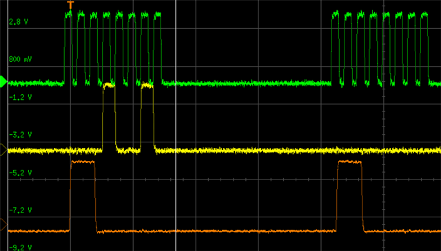

    attached the clk,mosi,miso,cs waveforms,
    Is this early MISO activity (on the first byte) expected behavior from the ADS131E04?
    As shown in the waveform, the first status byte (0xC0) appears both during the first and second clock byte cycles. Ideally, it should appear only during the second clock byte, but it seems to be duplicated or shifted early on MISO.
    refer the below image,
    Please let me know if need any other details to debug the issues.

  • Hi Manikandan,
    I am really sorry that we are unresponsive this week. The application experts for this device are all out of the office this week.
    Your SPI communication looks correct to me. You can simply disregard the first byte on MISO while you are transmitting the RDATA command on MOSI. The first byte will always be (0xC0 + FAULT_STATP[7:4]). The important data starts with byte two on MISO, again with (0xC0 + FAULT_STATP[7:4]).
    The channels which are powered down always read 0x000000. That is correct.
    Why channel 0 reads 0x7FFFFF is not clear to me yet either. As a first debugging step I suggest to set MUX0[2:0] = 001b. This will short the positive and negative analog inputs to mid-supply internally. You should then read a value close to 0V. Please try that and report back.

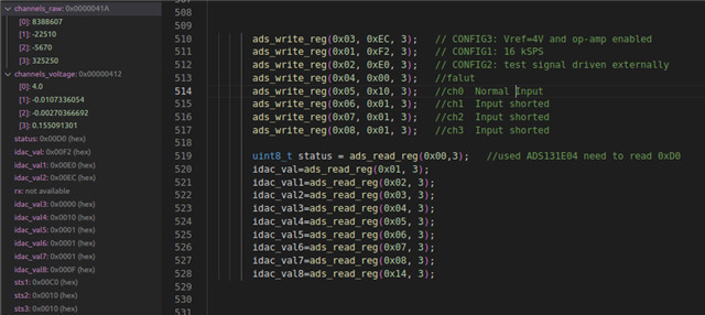

    As suggested, I configured the device for the internal short test by setting MUX0[2:0] = 001b. After enabling this configuration, the output values are now reading close to zero across all channels, as expected.
    I’ve attached the measurement results and the configuration snapshot for your reference.
    Please check and let me know if there are any additional checks or configurations you would recommend next.
    Thanks and regards,
    Manikandan V
  • Hi Manikandan,
    thanks a lot for performing this test. It looks like the ADCs are converting properly and you can read the conversion data.
    Which register bits do your "status = 0x00D0" refer to?
    As a next step you can apply a known signal on the inputs again. I suggest to start with something simple. The device does not support single-ended measurements where the negative analog input is connected to AVSS, but for debugging purposes we can use that. Means connect INxN = AVSS and for example INxP = 1V. Don't drive the INxN input with the buffer or anything to level-shift it for now. You should read a value slightly less than 1V in this case.
    If this works, then we just need to find out what is wrong with your circuit implementation according to Fig. 58.

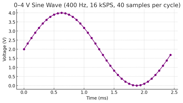

    We are currently providing the input signal from a Digilent Analog Discovery 2 device using crocodile clips.
    At the moment, the IN1N pin is connected to the Digilent negative output (GND), and the IN1P pin is connected to the positive terminal of the Digilent device.
    I’m still not completely clear about the DC bias requirement on the IN1N pin — could you please explain this in a bit more detail?
    As suggested, we will proceed with implementing the device self-offset and gain calibration routines.
    Below are the details of our input signal conditions:
    1. –125 mV to +250 mV DC signal — with step increments of 2 mV.
    2. 0 V to 4 V, 400 Hz sine wave — with step increments of 50 mV.
      • The sine wave is single-ended and positively biased.
      • Our original source signal is a ±2 V sine wave, which we bias through a differential op-amp stage (with reference voltage) to create a 0–4 V swing before feeding it into the ADC.
      • This setup was originally designed for a single-ended ADC, and the PCB is already fabricated. We later switched to this simultaneous sampling device to optimize acquisition timing.
    We have approximately 25 analog input channels with different voltage scaling configurations. Each channel is conditioned to fall within the ADC’s readable range.
    Our lowest input signal amplitude is 2 mV, and we’d like the ADC to be able to accurately capture such small levels.
    Could you please suggest the recommended configuration or best approach for using the ADS131E04 to handle these signal conditions effectively?
    Thank you once again for your valuable support and guidance.
    Below is the example image of our ADC input :
