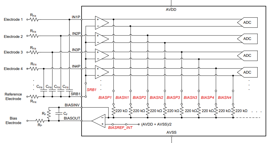

According to the datasheet, the INN1–INN4 inputs should be internally shorted to SRB1 when SRB1 is enabled.
However, in my case this internal short doesn’t seem to function as expected.

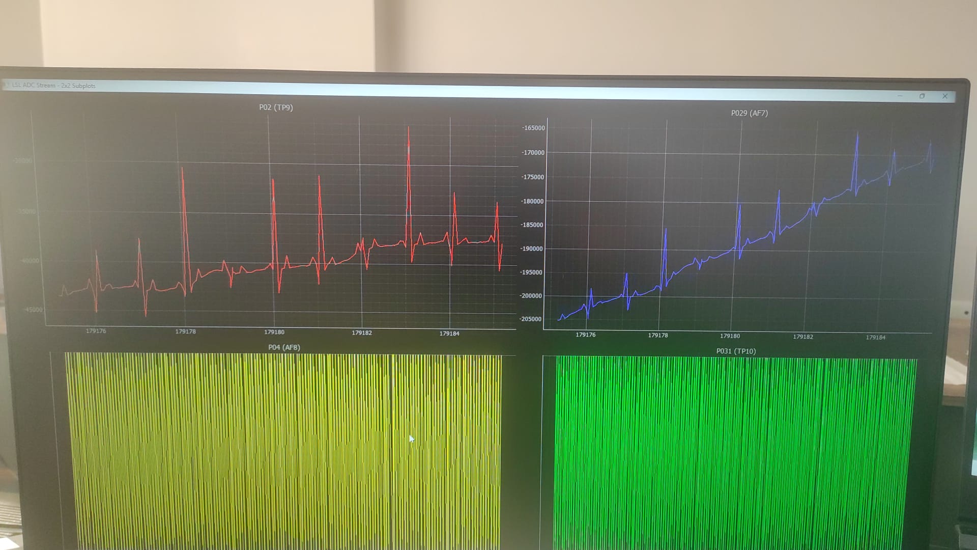

  • When I apply an input signal to channel 4, I can see the output on channel 1 and channel 3. and channel 2 and 4 are full of noise
  • When I apply an input signal to channel 1, no output is observed on any channel.
It seems that the SRB1 internal connection is not properly working or not being configured correctly.
The design is exactly the same as schematic above.
Questions
  1. Could there be a configuration or register setting that prevents the internal short between SRB1 and INN1–4 from being established?
  2. Is my setting of MISC1 = 0x20 correct for enabling SRB1?
  3. Do I also need to set any specific bits in each CHnSET register to connect INN lines to SRB1?
  4. On the hardware side, should SRB1 be left floating (not tied to bias or reference) when used internally?
Any insights or debugging suggestions (e.g., register dump comparison, internal mux test methods, or expected impedance measurements between SRB1 and INNx or any hardware rework) would be greatly appreciated.

    1. SRB1 switch will be closed as long as MISC1 = 0x20, and MUX[2:0] = 000, 110, or 111.
    2. Yes, MISC1 = 0x20 is correct.
    3. You can set MUX[2:0] = 000 to configure the channels as Normal Electrode input. the PGAN will be automatically disconnected from INxN pin and replaced with the connection to SRB1 pin when MISC1 = 0x20.
    4. SRB1 should not be left floating. There is no "internal" reference electrode option in the ADS1299. The INxN signal must either connect to SRB1 or to the individual INxN pins.
    Since you are using a 5-V supply, the expected input common-mode is 2.5V. Can you connect a 2.5V DC voltage to SRB1, and a function generator output to each INxP input pin to test the channels one at a time? The function generator can be configured as any arbitrary input waveform (i.e. 10Hz, 100mVpp sine wave) with a DC offset of 2.5V. Be sure to share the PCB ground with the ground of the function generator and DC voltage source.
