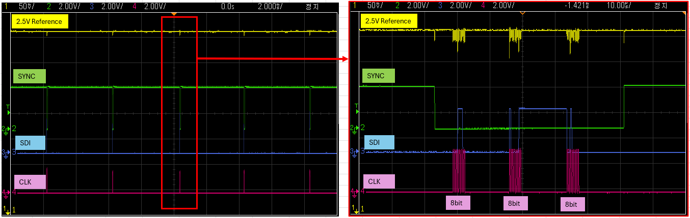

Normal operation:
The MCU sends 3 sets of 8-bit data (total 24 bits) via SPI, and the SYNC signal is closed immediately after transmission. In this case, the reference voltage remains stable, and no significant current flows into the VREF pin.

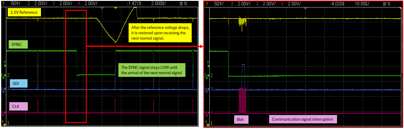

Error condition:
The transmission is interrupted after only one 8-bit data packet is sent, meaning the full data is not delivered to the DAC. During this state, the SYNC signal remains open, and a large current flows into the VREF pin, causing the reference voltage to drop. The voltage only recovers after a normal signal is received again.

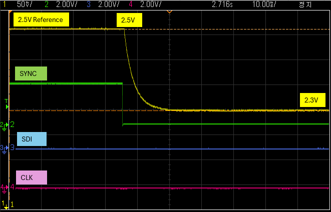

    4. Reproducing the issue:
      As shown in the figure below, we held the SYNC signal low for an extended period without providing any Data or Clock signals. We observed that the 2.5V VREF eventually dropped to approximately 2.3V. During this time, the current flowing into the DAC’s VREF pin was measured to be around 408uA (Under normal operating conditions, the current is approximately 14 µA). Could this behavior be caused by the prolonged low state of the SYNC signal?
