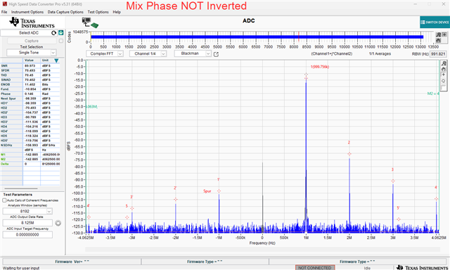

Issue:
We inject a tone at IF+1 MHz (13.824 MHz + 1.0 MHz) and expect to see a tone at +1.0MHz when performing a complex FFT on the output of the ADC.
What we see is a tone at -1.0 MHz which would be the case if I and Q are swapped. What is causing the problem. Do we have misconfiguration somewhere?

    Ah, I see. What you are experiencing (seeing a tone at -1MHz when you are injecting a tone IF + 1MHz) is expected behavior for this ADC. The ADC was designed this way because it simplified the design of the DDC filter. Unfortunately, this is not explained very well in the datasheet. The user must just keep in mind that the output data will be mirrored across the NCO frequency, meaning Fout = -(Fin - Fnco). However, setting the MIX PHASE field in register 0x27 to 1 should mirror the output again, meaning Fout = Fin - Fnco. I set this up in the lab and took a quick (unfiltered) capture just now to verify this behavior. Please see the below images, Fnco = 12MHz, Fin = 11MHz.

  • Hi Luke,
    Thank you. We just tried again with the Mix Phase inversion and it seems to behave as expected.
