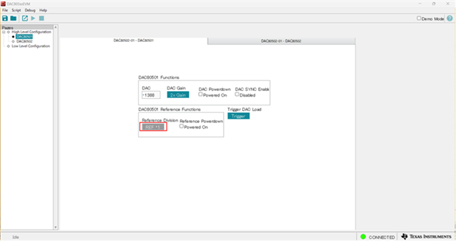

  • Hi Erin-san,
    Regarding question 2, my customer uses 3.3V output external power supply for VDD of DAC80502/1, and the DAC output is normal when the GUI setting is below.
    Based on your answer, Reference Division needs to be REF*1, not REF*2. however my customer mentioned REF*2 works, and REF*1 doesn't work. Is it okay to set REF*2 for Reference Division even when the external power supply is 3.3V?
    I cannot understand why customer's situation works..
    Shunsuke Yamamoto
  • Hi Yamamoto-san,
    Sorry, my explanation was confusing! "REF *2" is the correct configuration for VDD = 3.3V. When I said "please select the "REF ÷1" button", I meant to click it so it turns into REF*2.
