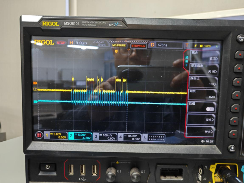

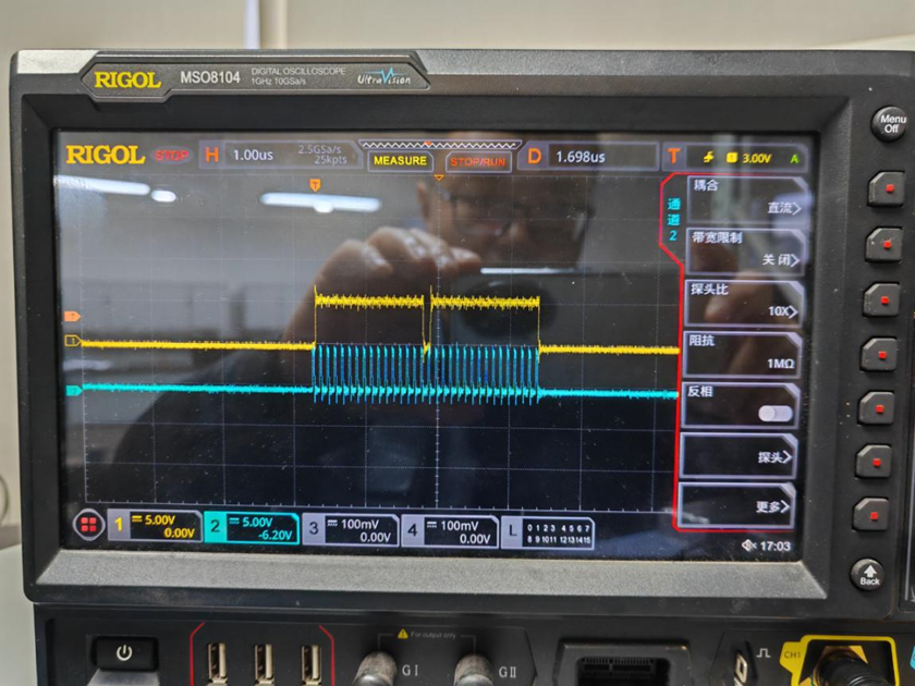

Abnormal AD data waveform at -20℃ (should be 0x7fff, actual AD output 0x4079)
Normal AD data waveform at -20℃ at 5V (0x7fff)

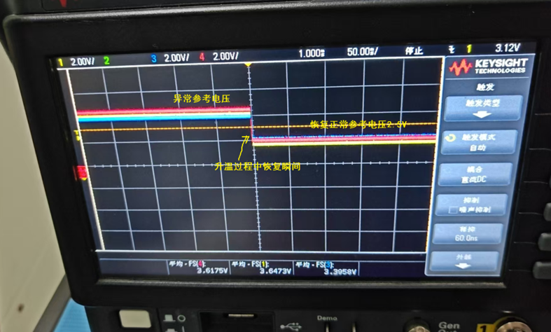

After investigation, it was found that the faulty sample product had abnormal REFA, REFB, REFC, REFD and REFIO when powered on at low temperature (-20℃), as shown in the following figure:
It is manifested as all reference voltage values not being 2.5V after power-on. The reference voltage anomaly measured in the above figure cannot be restored by setting the AD RESET pin high either. This leads to abnormal voltage values collected by all AD channels.
2) Inspection situation during the process of restoring to normal temperature
The above-mentioned faulty samples were restored to room temperature, and the reference voltage values were monitored in real time. It was found that during the temperature recovery process, all reference voltage values returned to the normal 2.5V during the heating process (the product was continuously powered on during this process without any operation).
