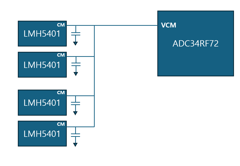

I am planning a front-end design using the ADC34RF72 with LMH5401 fully differential amplifiers.
I have a question regarding the common-mode voltage connection.
As shown in the attached schematic, one common-mode output net from the ADC34RF72 is routed to the CM pins of four LMH5401 devices. A 0.1 µF capacitor to ground is placed close to each LMH5401 CM pin.
  1. Is this connection topology acceptable (one ADC34RF72 common-mode net driving four LMH5401 CM pins)?
  2. Is placing a 0.1 µF capacitor near each CM pin sufficient, or do you recommend an additional RC filter or any other network for better stability or performance?
