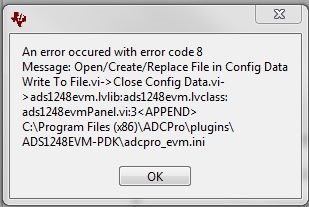

Where do I get the firmware for the MMB3 1247 code: stated I had to ask the forum. Also AdcPro Erro code 8!

  • I am using the ADS1247EVM
    Windows 7: requires AdcPro to be ran as Admin mode (Run Program as Administrator)
    Can you send me the firmware sample code (MMB3 Dev board)?
    Does this AdcPro app work with Win7? It appears to....
  • Floyd,
    As I mentioned before, to use ADCPro with the ADS1247EVM-PDK you must make sure you are using the ADS1247EVM-PDK plugin.  Unfortunately APCPro does not yet work on Win7, only XP.  The conversion process should be finished in the coming months, but at this time we are not able to support Win7.
