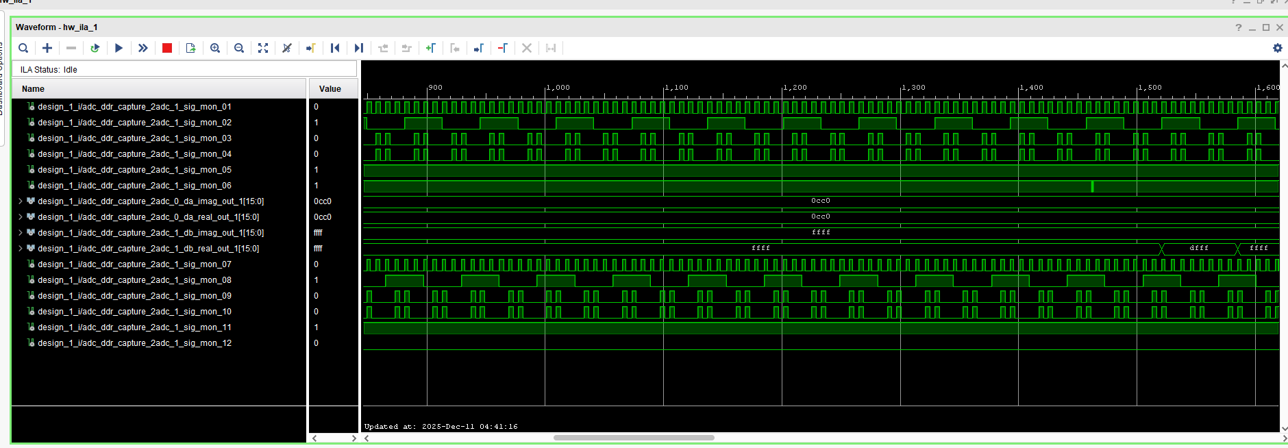

Following is the data capture screen shot.:
The first ten signals belong to ADC-1,  and the following signals belong to ADC-2.
 sig_mon_5/6 and sig_mon_11/12 are the b channel of ADC1 and ADC2.
What could be the possible causes of this problem?

  • Hi Luke,
    Thanks for sparing your time to help me with the issue. Sorry for not being  very clear. What I meant by chanel B was actually  DDCB. I configured DDC MUX in register 0x24 as 0x01. This setting directs Channel A to DDC A and DDC B.  I expect that when both TEST PAT A and TEST PAT B in register 0x14 are set to constant pattern (011),  pattern programmed in 0x14,0x15,0x16 will be output in both DA0/DA1 and DB0/DB1 lanes. I see the pattern  only at DA0/DA1 lanes.

  • Hi Luke,
     I write to the registers in the following order. The problem continues. However I observed that every now and then both da0/da1 and db0/db1  output test pattern. But it is very rare.

    [ADC1] REG_OUTBUF_PDN (0x0009) -> 0x00 (rb=0x00)
    is software reset alternative to hardware initialization?
    I connected REFBUF pi to ground thru 0.1 uF capacitor. Could this be the source of the problem?

  • Hi Luke
    It rarely works after power cycling. I pulled the REFBUF pin to AVDD. It did not help.

  • Hi Luke,
    1. No, I am not following the initialization sequence given in section 9.2. I assumed that performing a soft reset would be sufficient.
    2. For the second ADC, one of the DB outputs is held high and the other is held low.
    3. Yes, I am observing this behavior on both ADCs.
    4. I think it would be better to move this discussion to email. My email address is ali.dengizek@iewtech.com. If you share your email address with me, I can send you the schematic.
