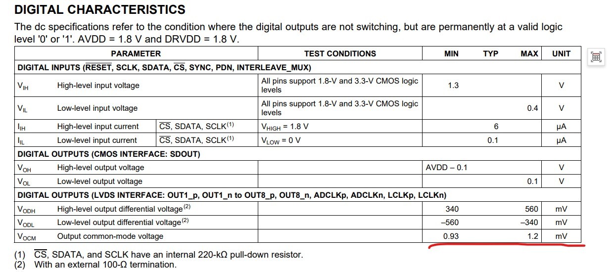

Dears,
I found the ADS5296A high-speed ADC chip on the TI official website. There is a question about one of the indicators in the specification sheet. Could you please help confirm it Specifically, as indicated by the red underline in the picture: Is the common-mode output voltage unit V or mV?12345678.jpg
