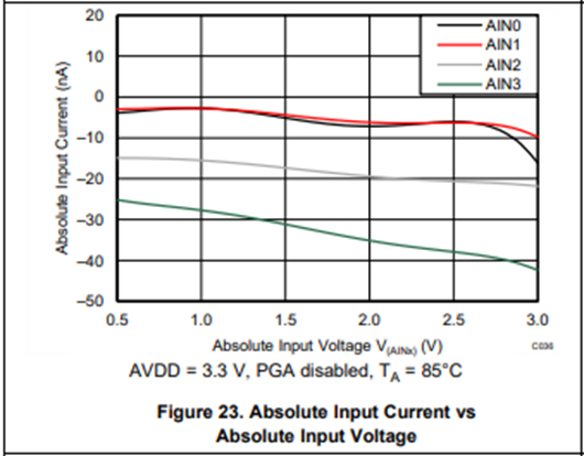

1) Any general concerns regarding this proposal?  Bob Benjamin mentions in another thread on the topic of ADS1220 and NTCs that the input leakage will be the biggest issue here. Device operating temperature is targeting -25C to +50C under which it seems that these leakage currents could be below 5nA on AIN1? We are targeting accuracy on better than 0.3C for high accuracy temperature sensors (PT100 etc) and can likely accept a little worse accuracy in the case of NTC 20k thermistor at 800k (~ -40C).

    1. Yes the input leakage could be a factor when measuring the NTCs, on page 12 and 13 in the data sheet there includes some graphs related to this. For an operating temperature of -25C to +50C AIN1 the leakage current should be below 5nA. AIN2 could have a slightly higher leakage current at temperatures >25C (see graphs below from page 13 of data sheet)
    2. Using an external reference with ADS1220 would be best for the noise performance. AVDD can be used however it does come the possibility of noise of AVDD directly affecting the ADC performance.
