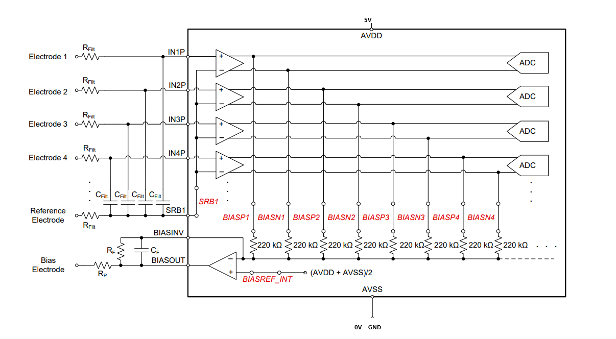

I am working on a custom EEG hardware design using the ADS1299 and I am experiencing significant issues with signal resolution and noise performance that deviate heavily from the datasheet specifications.
Here is my system overview and the problem details:
Hardware & Power Architecture:
  • Part: ADS1299 (Custom Board Design)
  • MCU: Nordic nRF52 series (Data is transferred via SPI to MCU, then BLE to PC).
  • Power Supply:
    • AVDD: 5V (Unipolar Supply, AVSS = 0V)
    • DVDD: 3.3V
  • Input Configuration:
    • 4 Signal Inputs
    • 1 Bias Electrode
    • 1 Reference Electrode (Using SRB1 for referential configuration)
Configuration Settings:
  • Gain: 24
  • Data Rate:: 250 SPS
  • Reference: SRB1 enabled (Referential montage)
  • Register Settings: (Please see the attached screenshots of my register map).

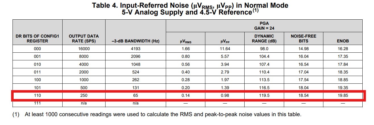

The Issue: Based on the ADS1299 datasheet, at Gain=24, I am expecting a much higher dynamic range and approximately 18.5 bits of noise-free resolution.
However, in my current tests, I am effectively getting only 11 bits of data, with approximately 8 bits being noise-free. The noise floor is significantly higher than expected.

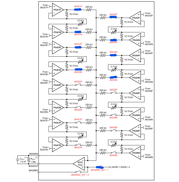

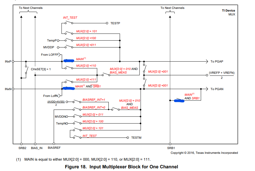

  1. Can you help me identify the source of the problem I'm experiencing?
  2. Could you review my register settings (attached) to ensure I haven't missed a critical configuration for the SRB1/Bias setup?
Any advice on troubleshooting this noise floor issue would be greatly appreciated.
