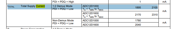

I have a question regarding the current consumption.
According to datasheet supply current is 2.105A for ADC12D1000.
What is the margin that I have to use for the power supply in this case?
Can I use 2.105A as the max value?
I am planing to use TPS7A53B to suppply this ADC. However, the temperature is very high, also i want to keep the current 70% of the Iout max of 3A (2.1Ain this case).
