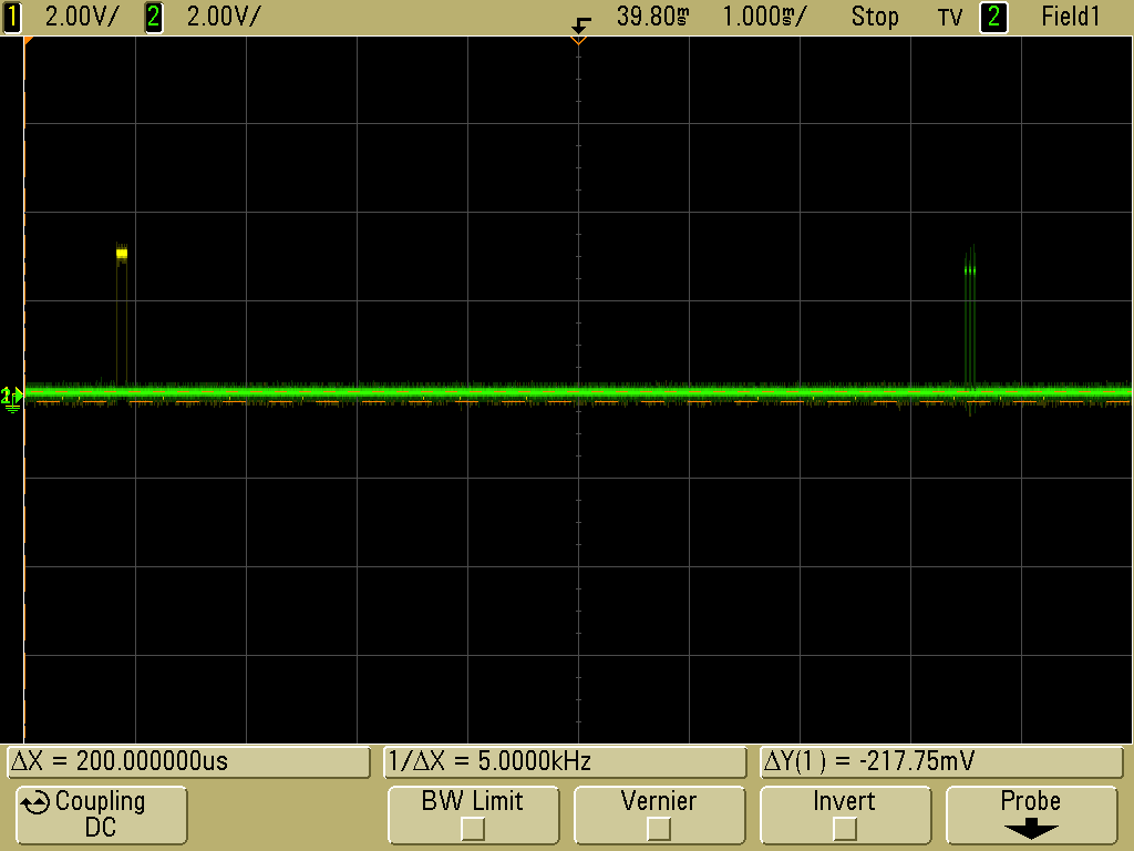

  • I am having a problem with the ads1224evm I am using. The ADC is able to generate the DRDY pulse, but not sending the data even when the clock signals on SPI interface are sent. I checked it on the CRO and confirmed the same. I tried changing the reference volatge to external reference of 2.5 volts, but it is not working properly/
  • Kedar,
    All digital pins must be connected to a valid digital high or low.  What value of MUX input settings are you using?  What does the data look like when you send the SCLKs?  Can you send me some scope pictures of the communication?  What values of data are you expecting to see?  Do you have all the necessary supply voltages, in particular +5V for AVDD?
    Bob B
  • Hi Bob,
    Thanks for the reply, I am connecting the ADC differential input with the negative pin grounded and to the positive pin I am giving a square wave pulse of peak to peak amplitude of 1 volts, being offset by 1 volt so the it is bounded between 2v-1v to avoid giving negative voltage to the input. I testes it earlier and was giving the values accurate for supply given, but now the after the DRDY pulse, the pin goes to zero when the clocks are sent. The yellow is the probe at DRDY/DOUT pin and green is SCLK. I am connecting the MUX inputs to the output of P10.0 and P10.1 of MSP430F5438A board.
  • Kedar,
    Are you absolutely sure that the MUX selection matches the inputs you are using?
    Bob B

  • I am able to get +5v at AVDD of the chip. I just now removed the external Vref and used the switches on board to get +2.5v as Vref+ and grounded the Vref- pin, but the 2.5v test point is showing 0.845v, but the pin 20 of chip shows AVDD= +5 v. Also the voltage across C18 is 0.4 v when onboard switches are used to generate Vref I am not able to understand the reason behind it as I was getting the proper voltages in my last run. If the zener diode and opa350 assembly is bypassed and external Vref is given then the voltage across C18 is 2.5 v but output in both the cases(with and without external Vref) is still zero.
  • Kedar,
    I'm suspecting a bad analog ground.  Make sure that you have the negative lead on the true analog ground point when measuring the analog voltages.
    Bob B

  • Kedar,
    But were you actually connected to the analog ground?  The board has two ground connections.  Where do have the supply connections connected to on the EVM? Where do you have the jumpers connected on J4?  If you can't get the proper voltages from the on board reference then something is damaged or something is not connected properly.

  • Kedar,
    The testpoint reading is more like the diode is being forward biased instead of reverse biased.  If you supply connections are correct, then something has been damaged along the way.  If one of the reference components has been damaged, then most likely the ADS1224 is also damaged.
    I would look at each stage and try to discover which parts have failed, or are shorted.  One last thing to check on the digital side is to place a scope probe at RA2 and measure on each side of the resistor to make sure there isn't something shorting the DOUT line on the micro side of things.
