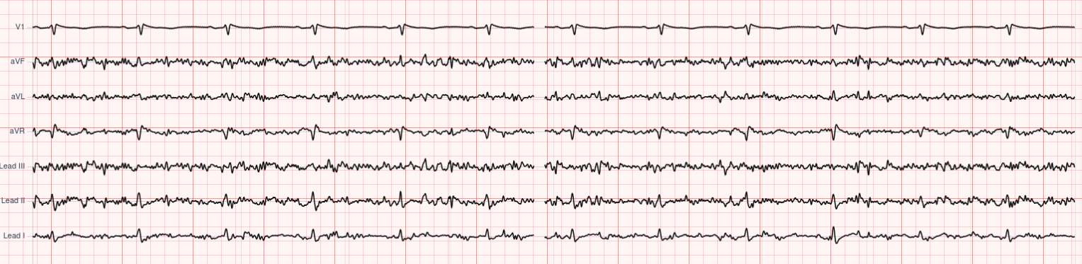

I’m currently working with ADS1294R incorporated device to acquire 5-lead ECG data. I’m using an ECG simulator to validate the system.  When respiration measurement is OFF, the ECG signals  appear correct. When I enable respiration measurement, the ECG data appears to be mixed with the respiration signal.

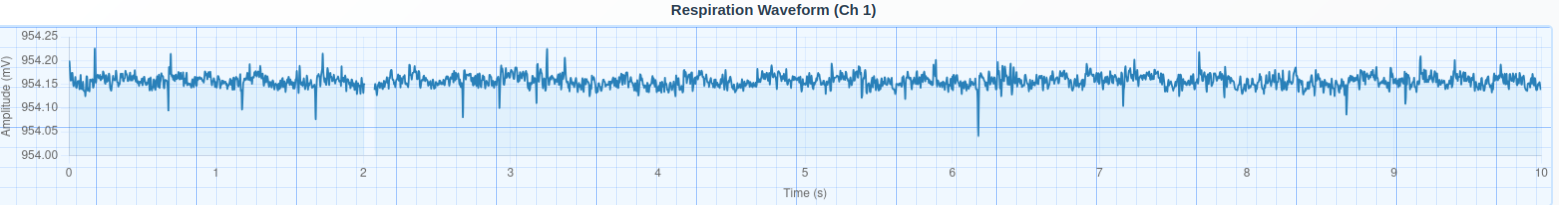

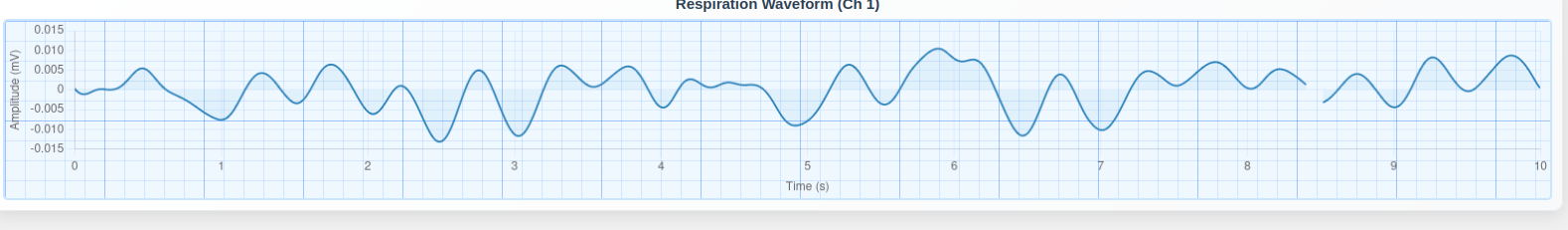

For better understanding of the issue, I’ve attached waveform screenshots for reference.
Raw ECG data
Raw Respiration data
Filtered ECG data
Filtered Respiration data

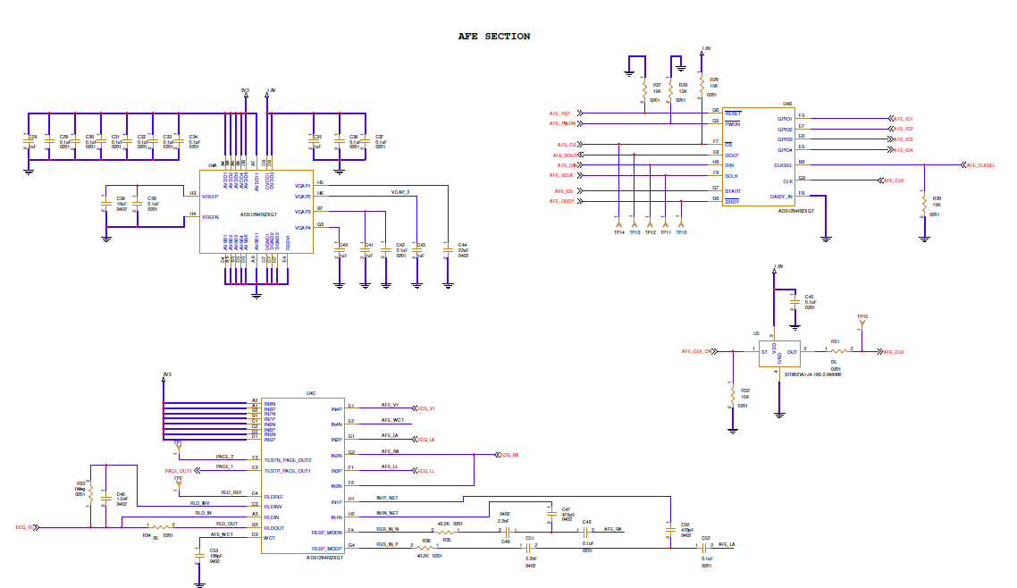

Schematics of ADS1294 in my device
Is this expected behavior when respiration and ECG share signal paths internally? Am I missing any configuration steps to separate respiration and ECG paths properly?

    In your schematic, I do not see any source which is establishing the common-mode voltage on the respiration receiver inputs (IN1P and IN1N). There should be either a resistor divider between the supplies, or a pull-up to RLDOUT.
    Typically, the respiration modulation signal will appear on all electrodes, but it should be filtered out by the digital filters since it is out of band and synchronous with the device's internal clocks. A first order low-pass filter could be added in analog to remove the carrier before it aliases into the passband, if you suspect that to be an issue.

    I do have a resistor divider between the supplies and filters for the ECG signals. I missed to attach it in my schematics, please find it below.
    Iasikha
