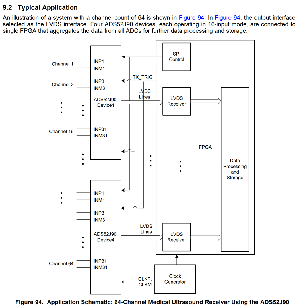

I aim to do simultaneous sampling with multiple ADCs(sampling timiming difference between channels within 1ns)
For example , datasheet has four ADS52J90(16ch) for 64ch analog input.
Q1
Can four ADS52J90 for 64ch analog input sample simultaneously?
Q2
For acheving sampling timiming difference between channels within 1ns, does the skew of  four sampling clocks(CLKM/N) and four trigger signals also need to be within 1 ns?
Q3
Are there any application notes or reference designs for applications using multiple ADS52J90s, such as the one described here?
ttd
    1. Multiple parallel devices can be synchronized by giving synchronization pulse on TX_TRIG pin. Please see the datasheet section 8.3.4 Device Synchronization Using TX_TRIG. This allows simultaneous sampling of all 64 channels
    2. Yes. The skew of  four sampling clocks(CLKM/N) needs to be within 1 ns. Regarding the TX_TRIG skew, it has to meet set up and hold time requirements with respect to system clock. Timing requirement of TX_TRIG with respect to system clock is mentioned in the datasheet. TX_TRIG signal eventually gets latched at the rising edge of system clock and minimum delay of latched TX_TRIG is 0.5ns.
    3. Application note for multiple ADCs is not available. Only datasheet has the application details.

    1.
    8.3.4 Device Synchronization Using TX_TRIG seems to describe only 32-Input Mode and 8-Input Mode. In my case, I'd like to use 16-Input Mode.
    Do you have any guidence and timing chart for 16-Input Mode?
    Does "System Clock" mean sampling clocks(CLKM/N) from external?
    My taget sampling rate is 10MSPS

    My target configuration is simultaneous sampling of all 256 channels with 16 ADS52J90s (16-Input mode/12bit/10MSPS)
    ttd
    1. In terms of TX_TRIG delay, it will be similar to Figure 60 Odd- and Even-Channel Sampling Instant Definition Mechanism in 32-Input Mode with the TX_TRIG. For the data sampling instant please refer to Figure 57, 58 and 59 of the datasheet. Figure 58 describes the data sampling instants for 16-input mode.
    System clock is the external clock applied at CLKM/P pins
    2. There is no feature to fine-tune the skew in the input clocks of the four ADCs
    3. Yes, sampling timing error is less than 0.1ns between 16 internal ADCs.
    Would the worst-case scenario result in a maximum sampling timing error of 1 ns between the two devices?  ---- Yes, it could be possible
    Across devices, the typical value of sampling timing error is 1ns. In system which has 4 devices, the typical variation across all devices would be 1ns.

    Q5
    Just to confirm, to summarize, is my understanding correct that the sampling timing errors of the ADC(10MSPS) within a device and between devices are as follows?
    ・Difference in sampling timing among the device’s 16-channel ADCs (not specified in the datasheet) → Within 0.1 ns (reference value)
    ・Difference in sampling timing between devices (δtAP) → ±0.5 ns (typ)
    Q6
    Does δtAP assume that the system clock fS (the external clock from CLKM/P) is applied to all devices at exactly the same timing (edge)?
    Q7
    Also, while four application examples are listed on datahseet, is my understanding correct that the standard value of 1 ns (±0.5 ns)  (δtAP) applies even when using 16 devices?
    ttd
    Q5: Yes. This is correct.
    Q6: Yes, this is assuming fs is applied to all devices at the same time.
    Q7: Yes. The variation of ±0.5 ns applies among 16 devices.
