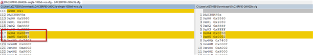

I attached files containing the register values used to program the DAC, and those read after initialization.
Ken
DAC38RF80-260423b-single-1000x6-nco.cfg DAC38RF80-260423b.cfg

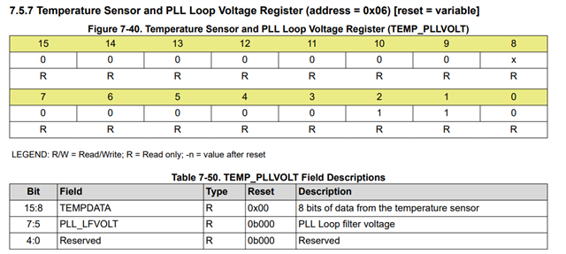

    1. are you using PLL? If so, can you read the following PLL_LFVOLT to ensure PLL is locked?

  • A little progress:
    PD is pulled down first
    RST_B is pulled high second
    TXENABLE pin is pulled high after writing the registers
    TEMP_PLLVOLT = 99C 4V

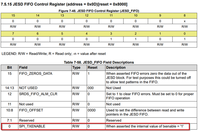

  • There was a problem with SYSREF. I looked at the statistics:
    SYSREF12_CNT = 0x0000
    SYSREF34_CNT = 0xFF00
    so I'm using
    SYSR_CAPTURE = 0xD800
    and I can now see SYNCB go low and go high when TXENABLE = 1.
    I powered down the SERDES transmitter.
    ALM_SD_DET is still 0x0050
    but SYNCB stays low.
    I'm now getting alarms:
    JESD_ALM_L0 = 0x0002
    JESD_ALM_L1 = 0x0002
    JESD_ALM_L2 = 0x0002
    JESD_ALM_L3 = 0x0002
    FIFO_ZEROS_DATA prevented output
    When I disable FIFO_ZEROS_DATA, the output looks pretty clean, even though I'm getting FIFO alarms.
    Is that OK?
