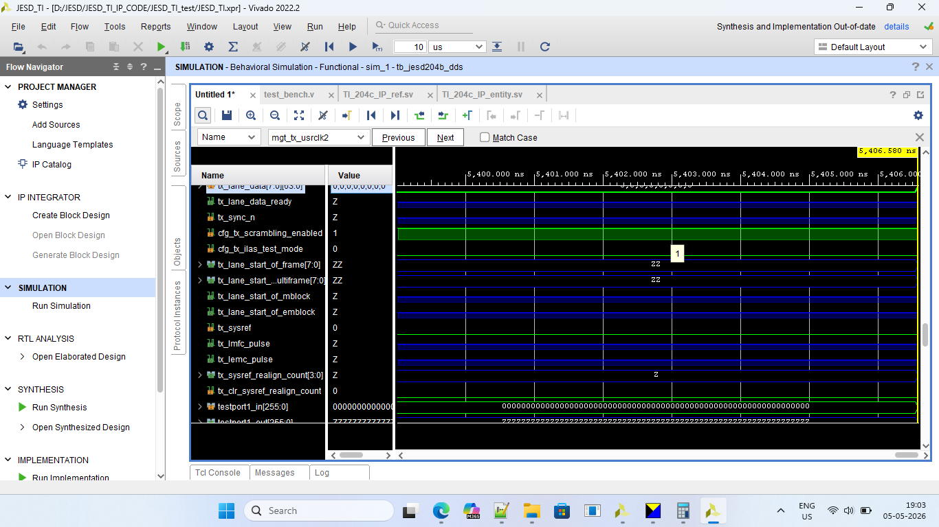

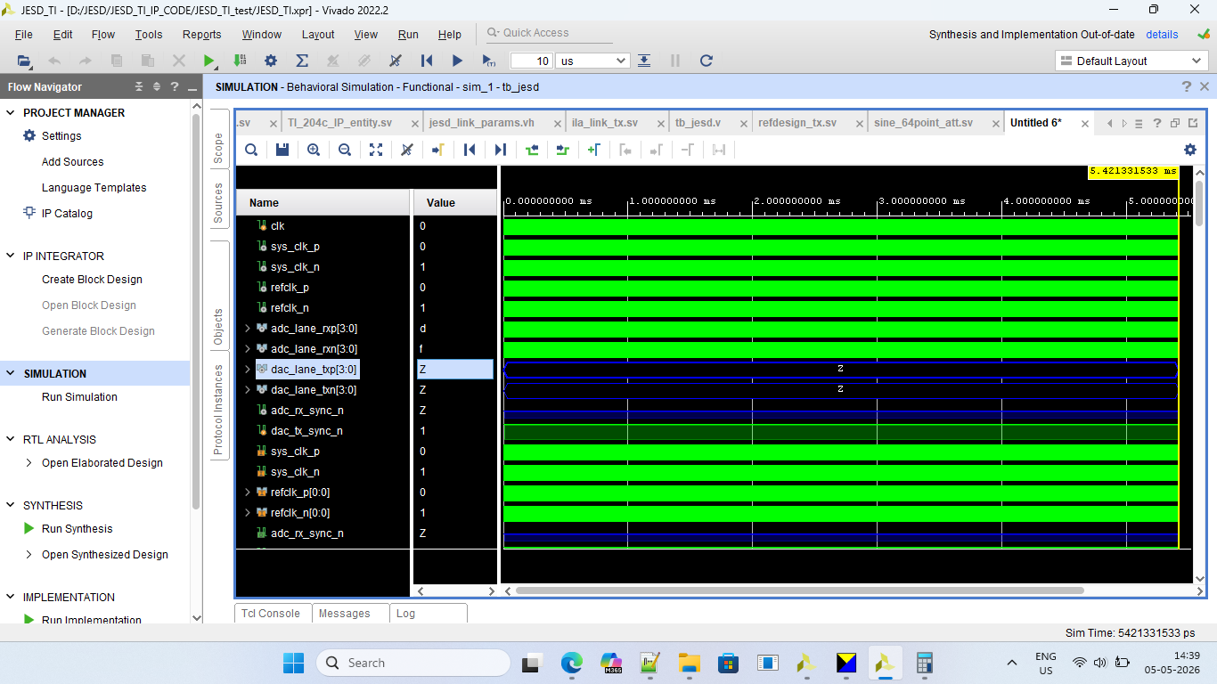

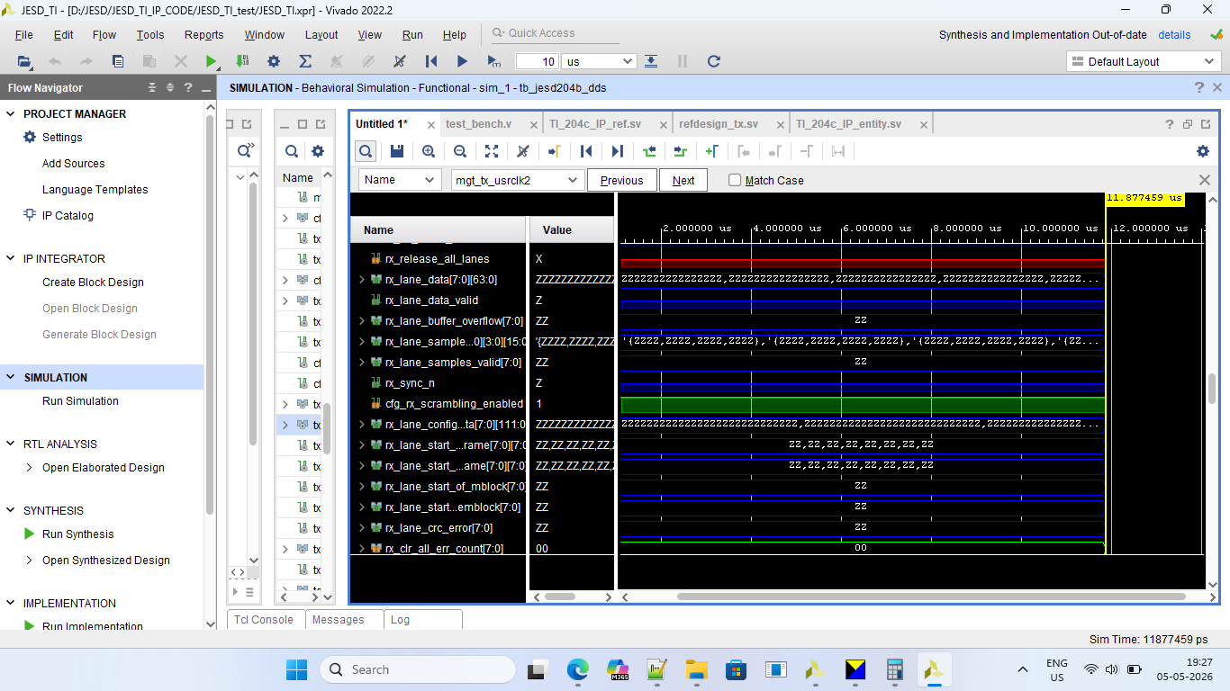

I am getting 'x' value even if i am giving all the signals to the transciver wizard IP in VIVADO 2022.2.We need some assistance regarding this and  we  are using xc7a200fbg484-2 fpga.

  • Hi - Can you please help to provide your LMFS configuration and sampling rate? Are you using a TI provided JESD IP?
    Are you able to put the device into transport layer test pattern mode to test the integrity of the link?

  • Alekhya can you please also answer if you are using a TI provided JESD IP?
    If you put the device into transport layer test mode are you able to see the expected symbols in the FPGA ILA?
  • Sorry for the late reply. yes i am using TI provided JESD IP. and YES. if not what is the reason for this?
