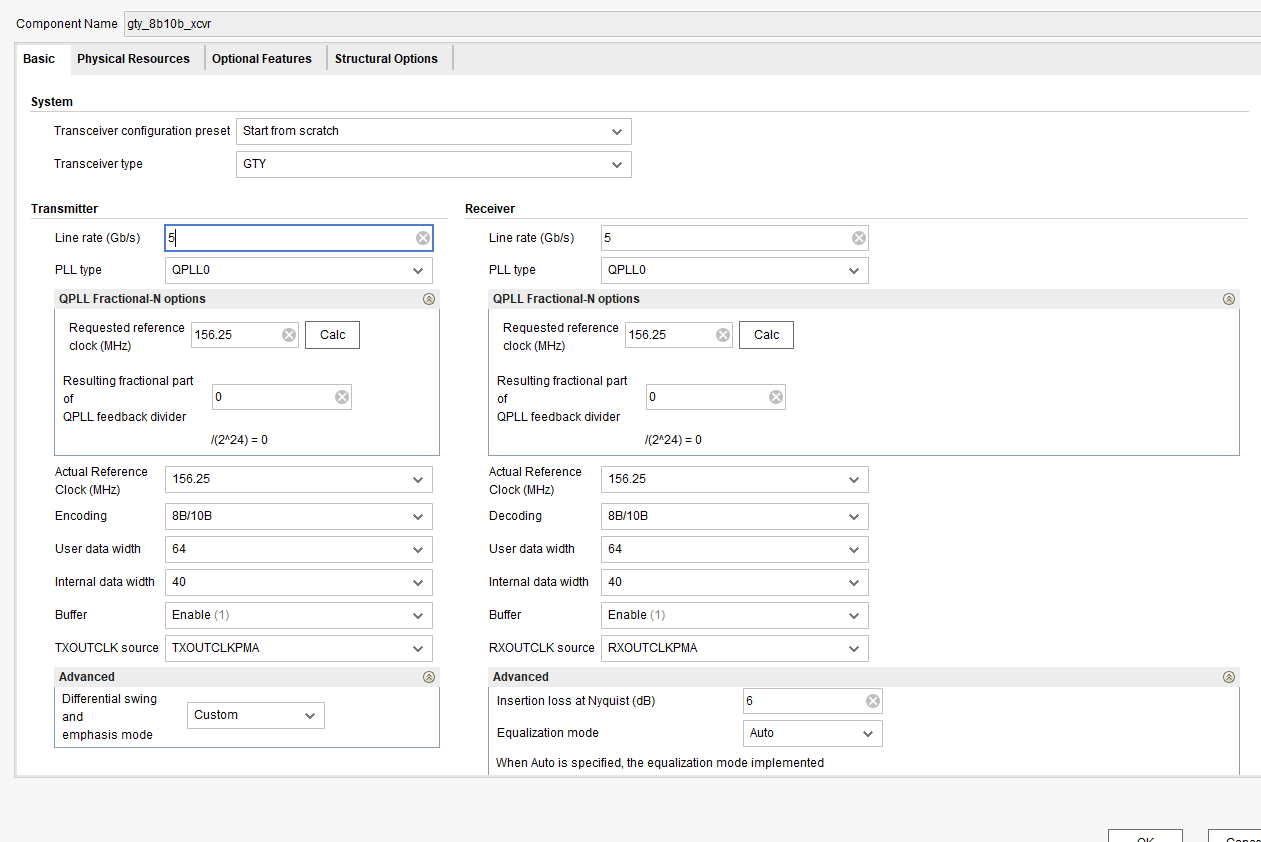

I am running a loopback simulation on TI_JESD204_IP and there is a lock issue with qpll0.
I ran the simulation in two environments, GTHand GTY, and there is a problem with the lock on qpll0 in the GTY environment.
First, the problem-free "GTH" environment is as follows:
  1. Vivado version : 2021.2
  2. TI-JESD204-IP Reference Design : zcu102_8b10b
  3. FPGA : kintex ultrascale, XCKU040 (GTH)
  4. Transceiver wizard's physical resource : QuadX0Y2(MGTREFCLK0) , QuadX0Y3(MGTREFCLK0 of QuadX0Y2)
  5. Results : qpll0_locked[1:0] is "11", so there is no problem. Loopback simulation is also fine.
Second, "GTY" environment is as follows:
  2. TI-JESD204-IP Reference Design : vcu118_8b10b
  3. FPGA : kintex ultrascale+ ,  XCKU3P(GTY)
  5. Results : qpll0_locked[1:0] is "01", so the second bit does not become 1.
And the transceiver settings are the same in both environments.
What could be wrong? Please help.

    Kindly confirm if the transceiver wrapper logic is identical in both cases. There is a possibility that the xcvr reference clock (gtrefclkxx_in) is not being connected correctly. It is a 2 bit input (as you are using two quads).
    Ameet
  • Hi Ameet Bagwe,
    I checked gty_8b10b_rxtx.sv in the TI-JESD204-IP Reference Design : vcu118_8b10b file using GTY.
    It works after changing .gtrefclk00_in (gt_refclk0_buf) -> .gtrefclk00_in ({NUM_QUADS{gt_refclk0_buf}}) in xcvr_gen.
    It seems that the NUM_QUADS parameter is missing in gtrefclk00_in in reference design vcu118_8b10b.
    It works after I modified it and ran the simulation again.
