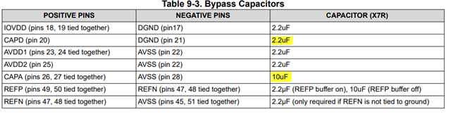

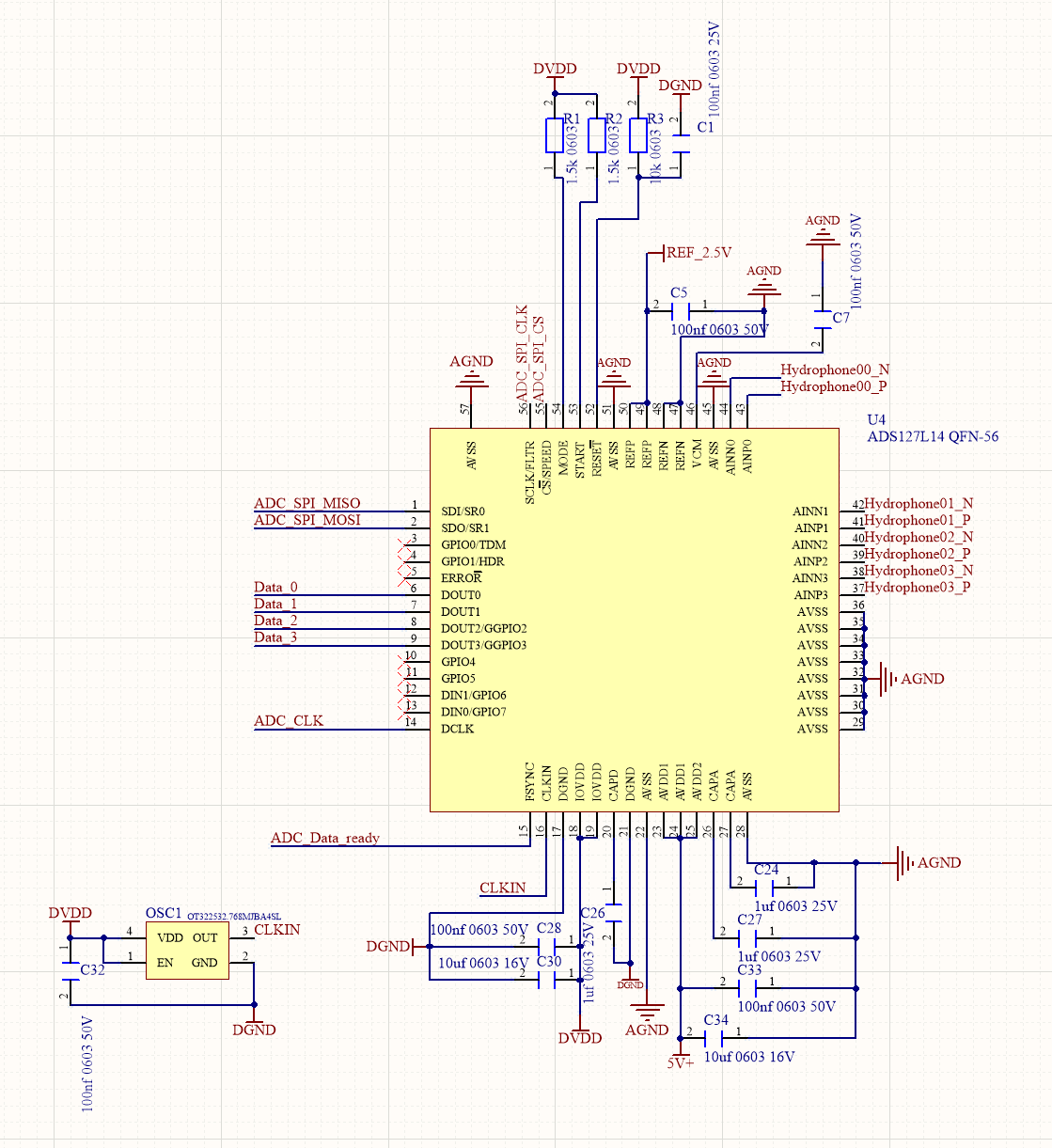

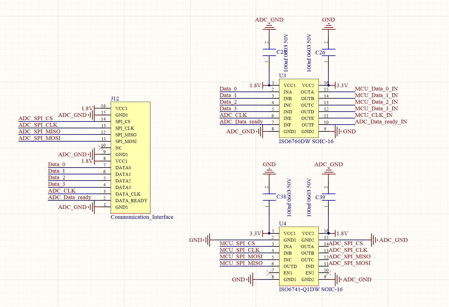

Hi Team,
Posting on behalf of our customer.
The SPI4 interface of the STM32H743 communicates with the SPI configuration port of the ADS127L14 via ISO6741 digital isolator.
Logic analyzer waveform verification confirms that the configuration data is transmitted normally, and the readback register values are completely consistent with the configured values.
I set the START bit to 1 in the control register CONTROL_REG_ADDR 0x07 to trigger ADC conversion. However, no valid waveforms are detected on DCLK and DOUT0~DOUT3.
I will provide my hardware schematic and related program code. Please help analyze the root cause of no data output. This issue has blocked my development for a whole month, and I have tried various troubleshooting methods without success.

    I have fabricated and tested the PCB based on the schematic provided to you. In my design, ISO6741DWR is used to isolate and connect the SPI4 interface of STM32H743ZGT7 to the SPI configuration port of the ADS127L14.
    Register configuration and readback are working properly. The logic analyzer captured the communication waveform on the 1.8 V low-voltage side of ISO6741 (ADS127L14 side), and the SPI transaction data matches the expected read/write results.
    I have attached the relevant initialization code functions. However, no valid output is available on the synchronous data port. Oscilloscope measurement shows only noisy, floating-like interference waveforms on the DCLK and DOUT pins, with no stable clock or data output.
    I have also tried pulling the hardware START pin low first, then setting the START bit via register command, but there is still no valid data output.
    I currently have several suspicions and would like your professional analysis:
    The ISO6760 defaults to a high level after power-up. Could this default high-level leakage damage the synchronous output pins of ADS127L14 by reverse current injection?
    Is the SPI register configuration sequence incorrect? I have tried multiple configuration combinations with no improvement.
    Additionally, please help confirm the following points:
    Do I need to externally control pins such as RESET, START, MODE, and TDM through the MCU?
    For example, should the MCU pull the RESET pin low for a certain duration after power-up before starting register configuration?
    Is additional port ESD or surge protection required for these interface pins?
    For the power supply design:
    The system 5 V is first stepped down to 3.3 V via AMS1117-3.3, then further stepped down to 1.8 V using AMS1117-1.8 to supply the digital domain of the ADS127L14.
    Please help analyze the root cause of the no-data output issue.

    My solution requires galvanic isolation for analog signal acquisition and data processing, so digital isolators are mandatory in the design.
    Meanwhile, the isolator also performs level conversion.
    The communication logic level of the STM32H743 is 3.3 V, while the ADS127L14 uses 1.8 V logic, making direct interconnection impossible.
    Danilo

    The ADS127L14 will not work correctly unless both CAPA pins are tied together, pins 26 and 27, and should have a single 10uF capacitor to AVSS.  On power-up, with default register settings and START pin pulled high, the ADC should output conversion results after a filter settling delay.
    In general, the customer should use the following recommended capacitor values.  However, for correct functional operation, the CAPD pin should be 2.2uF and the CAPA pins should be 10uF.  The other capacitors can be smaller or larger in value and the device will still work correctly.
    Additional recommendations:
    • For proper control over SPI, the START pin should be pulled low, to DGND.  This will force the ADC into STOP mode after a power-up reset until the START bit is written over SPI.
    • The unused GPIO pins should have either a pull-up or pull-down resistor since these are digital inputs after power-up reset.
      • Connect GPIO pins 0,1,4,5,6,7 to IOVDD or DGND using a <3kOhm resistor.
    • Since SPI works correctly, the following recommendation is likely already met.
      • Make sure the 1.8V power for the isolators is also connected to the DVDD net for the ADS127L14.
      • Make sure the ADC_GND, AGND, and DGND are all connected together on the board.
    • I see hydrophones are connected to the ADC input channels.  I assume you have some type of input pre-amplifier between the hydrophone sensor and the ADC inputs.
