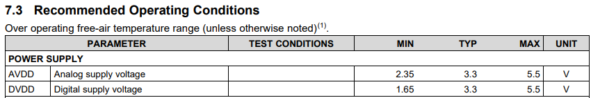

The ADS7028 has two power supply pins: AVDD and DVDD. Can it be used with the following power supply voltages?
AVDD: 5 V
DVDD: 3.3 V

Apologies for the delay in a response to this. I was out of office for an extended amount of time.
The analog and digital supplies of the ADS7028 can operate independently within their respective operating conditions. There is no supply sequencing requirement.
